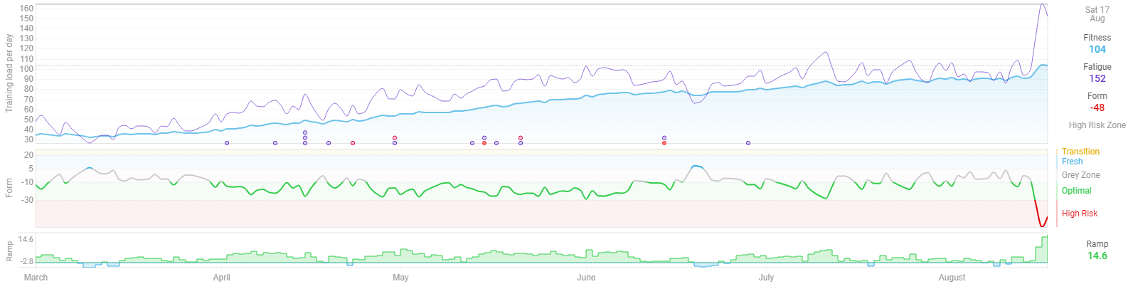

It seems like slowootwitch might be saying that a couple workouts isn’t going to be progressive overload, and then he shows a graph of increasing fitness over 5-6 months to reach success. It’d be nice if they could just say that, if it’s the intention.
