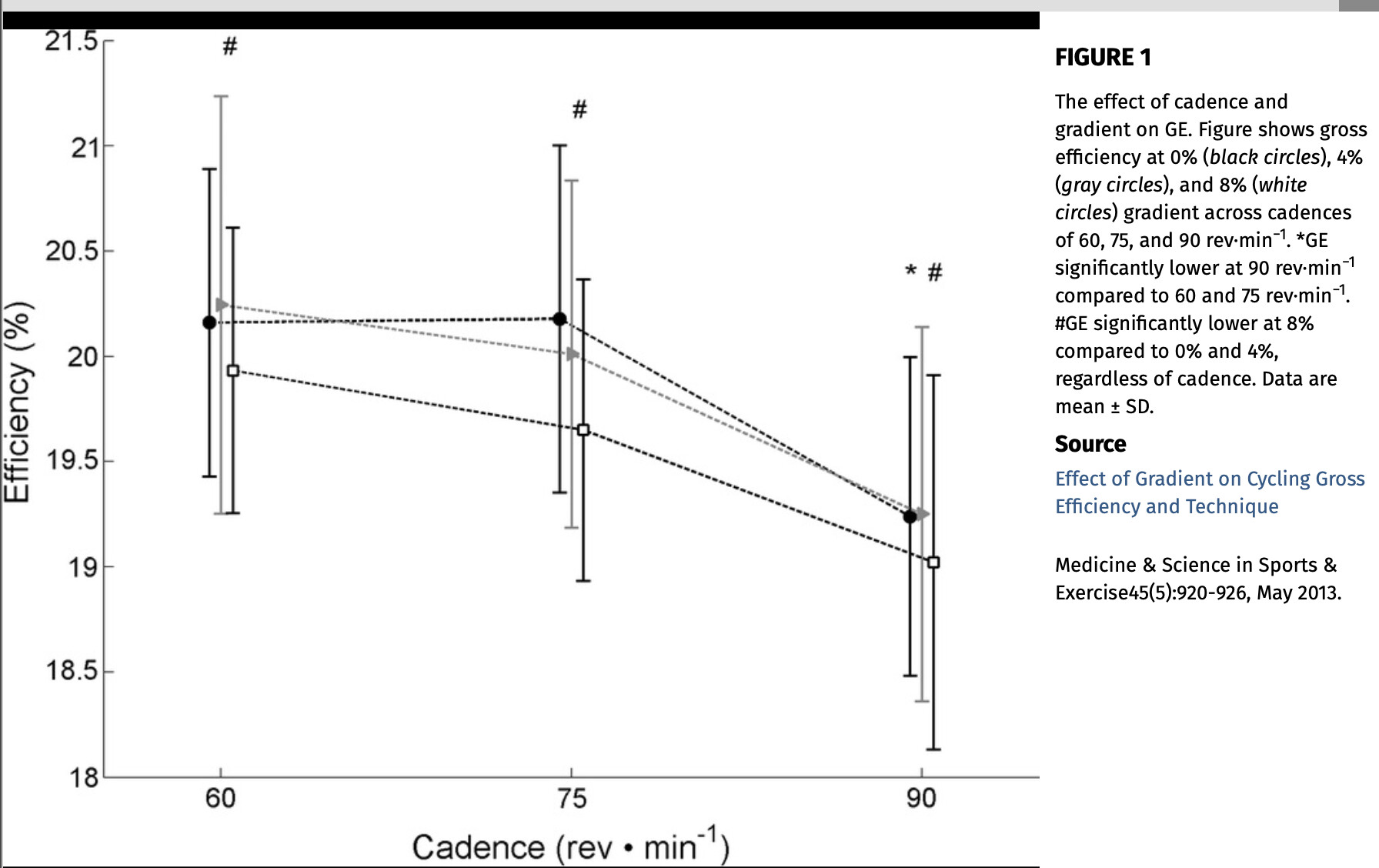

A lot of interesting studies on gross efficiency… Here is one comparing cadence on 0% (flat), 4% climb, and 8% climb:
Efficiency decreases with increasing cadence. Efficiency decreases on steep 8% climb.
There are other studies showing changes due to power.

Lab data? Because weighing food is going to use estimates of caloric value. And from my previous short trip down the rabbit hole, efficiency has been shown to vary due to power output, cadence, and gradient. Gross efficiency is a range, it’s individual, depends on route and power and cadence, and can change over a season.
