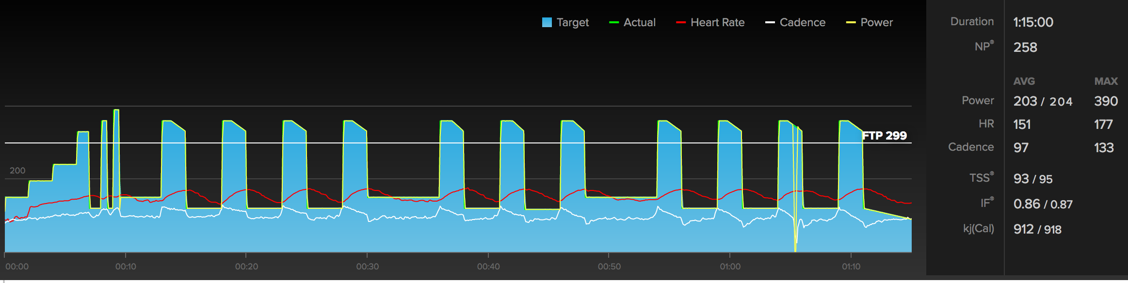

    ----This is where you are barely hanging on for the last few intervals or last few minutes – and maybe you have to take a backpedal or two. Or you dialed it down for the last interval, but only 2%-4% – but you pretty much hung in and got 99% of the benefit of the workout. Ignore this type of failure. Change nothing.
    Example below on Mills +1:

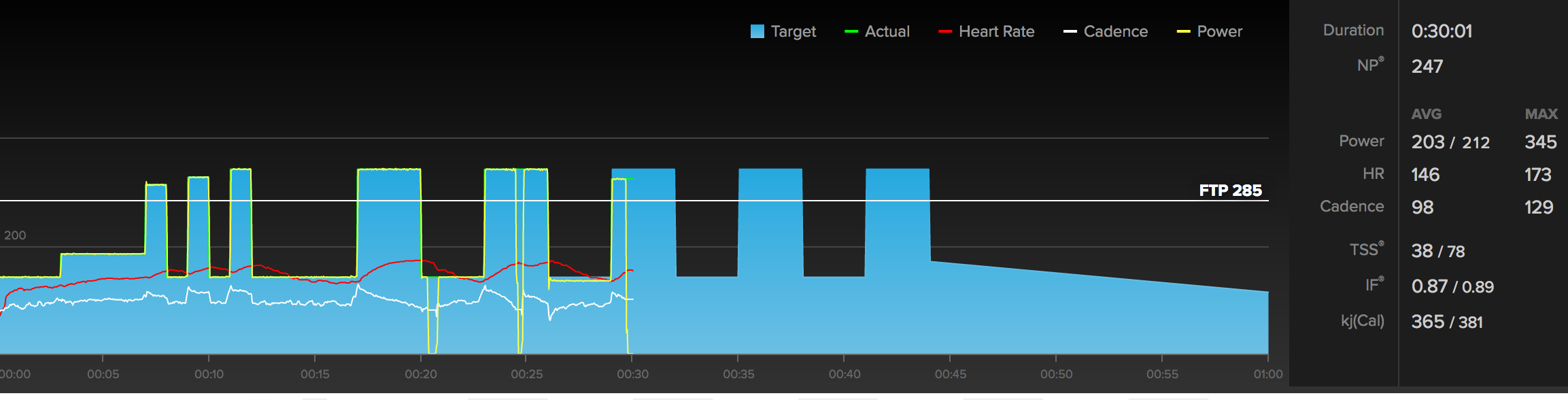

    ----You are overmatched. You start bailing out about 50% of the way through the workout. You backpedal. You dial down the intensity. You still backpedal. You dial it down again…and yet still backpedal. This is where you are going to want to re-evaluate and either ask yourself, 1) if you’re FTP is set correctly; or, 2) You are taxing a system that isn’t appropriately developed for what you’re asking of it . . . i.e. muscular endurance or Vo2. If the former is the case, obviously you’ll want to re-assess in some manner. If the latter is the case – you may want to minus down a workout, or find a workout that does the exact same thing, but in smaller intervals. For instance, if you can’t get through the 3 minute Vo2 intervals of Matthes +1, try doing a workout that has 2 minute intervals…or do the peak-and-fade of Mills and see where you are. Huffaker is also a great level-setting Vo2 workout. Or, if you can’t get through the 3x20 at threshold work of Galena +2, then try the 3x15 threshold work of Mount Goode or Kaweah and/or one of it’s derivatives. Once you can nail the stepped down workout, try punching it back up. In this way, I look at the Training plans as guides in terms of the type of work you should do, and also the weekly TSS. On threshold day, make sure you do threshold work – but pick a workout that isn’t going to destroy you. There are a HUGE number of ways to make up any missed TSS.
    Example of an overmatched workout below on Jepson:
