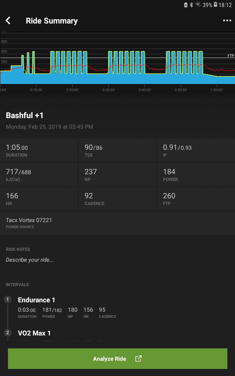

Bashful +1… now we’re cookin’ with gas. Erg mode/PowerMatch lagged 1:00 interval avg power by 1-2%, dialed up the final set to 102%. May try resistance mode next go.
Also played with gearing: first set in 39 chainring; first two intervals of second set in the 53; rest in the 39. 39 definitely the way to go for better power compliance on these, IMO.
Note: If you’re sleepy because of babies, VO2max work is just the ticket to wake your ass right up.
Bashful +1 for me as well. Definitely the last interval was going to be the last one.
Agreed. I was either done, or I was going to fall off the bike, hit my head on my crankarm, and knock myself silly. Either way…

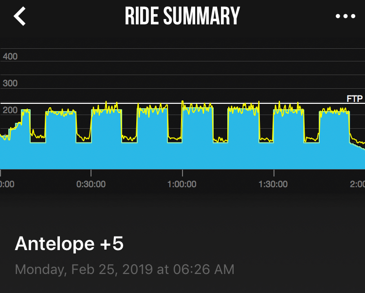

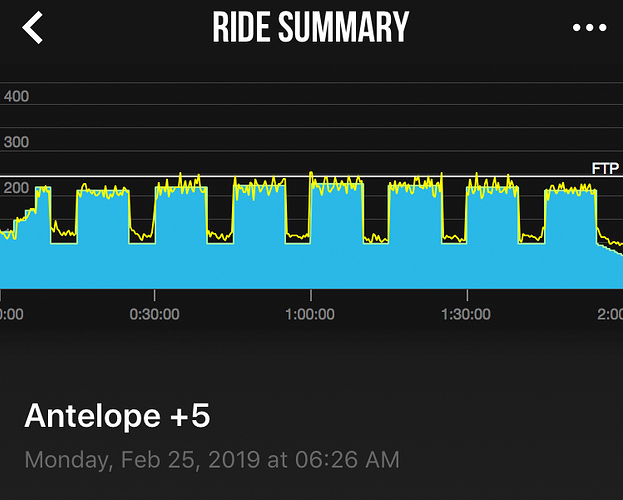

This was the hardest sweet spot workout I’ve done. I thought Antelope would be harder (5x10 min) but for whatever reason I was fried during the last effort.
