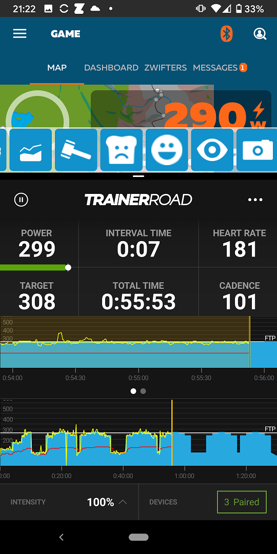

Chuffed that both trainerroad and the zwift companion work splitscreen on my Google Pixel :+1:
Sneaked up Ventoux whilst doing Mary Austin -1 last night.
