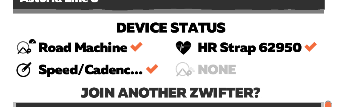

Please take and share a picture of your Device pairing screen in Zwift.

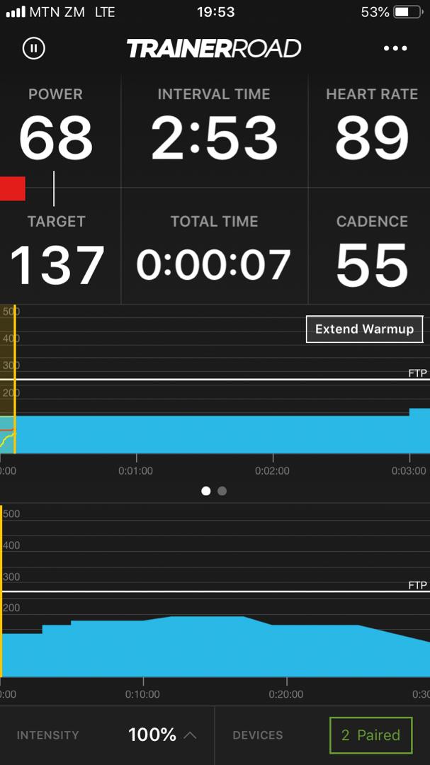

  1. Paired Road Machine and HR in Trainer Road App on iPhone and make sure they work fine
Then in Zwift on the Mac , connected HRMonitor, Speed / Cadence Sensor and Road Machine via Ant+ (I disconnected the Mac’s Bluetooth)
Made sure they show up:

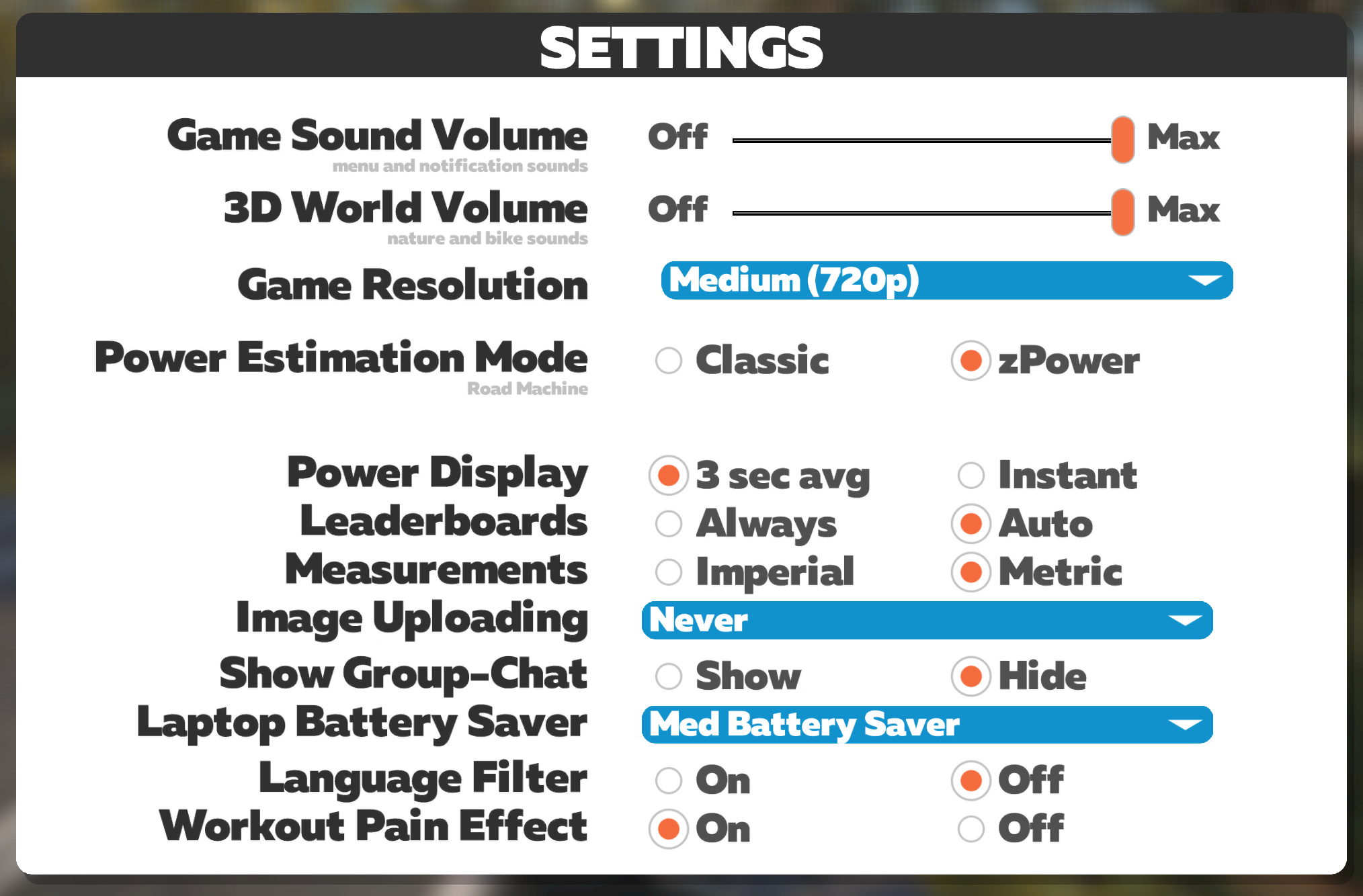

Then the settings screen set to Zpower…
BUT, cycling in Zwift, I can see cadence and Heart Rate, but Watts are at zero and my avatar is not moving at all
