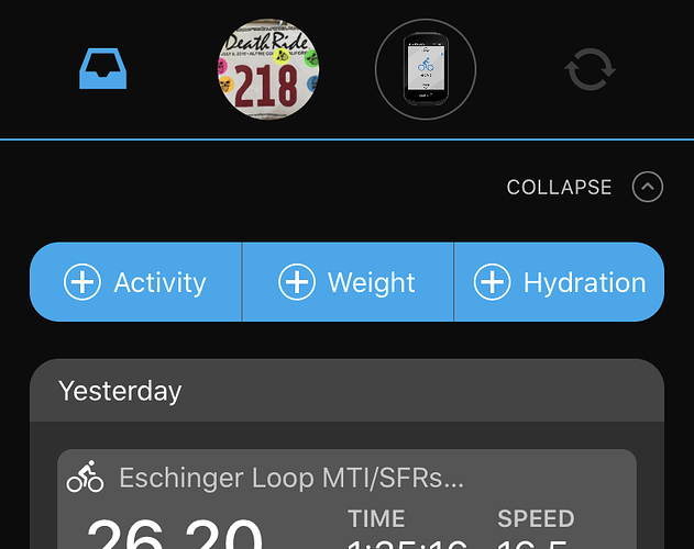

Just got myself an Edge 520 and have installed Garmin Connect on my iPhone. I have a scheduled workout for today which has been pushed to my Connect calendar (I can verify this via the iOS app). However, when I navigate to my ā€˜Training Calendar’ on my Edge 520 it says:
ā€œNo scheduled workouts saved. Go to Garmin Connect at www.garminconnect.com to schedule and download workouts.ā€ Likewise, if I go to the ā€˜Workouts’ section on my 520 it says ā€œNo workouts saved. Go to Garmin Connect at www.garminconnect.com to schedule and download workouts.ā€
According to iOS Bluetooth my phone and Garmin are connected, so what gives?
Try forcing a sync by clicking the icon in upper right of Garmin Connect.
That worked, thanks, Brian.
