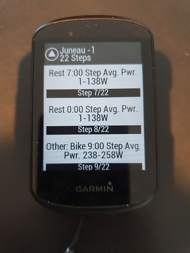

Did the outside version of Juneau -1 today
@Tommy - Could a “wait until lap button press” be put in at the end of the 7min rests between sets? If executing the 2x9 on a long hill, you don’t want the next set to start until you get back to the bottom
At the moment, it just has a Rest 0:00 after at least the first one

Hey @PWeber, thanks for posting this! I took a look at the outside workout file for Juneau -1, and it actually does have “hit lap once ready” prompts after the 9 minute rests already! If you weren’t getting them on your ride, it was most likely just due to a bad sync that altered the workout file.
This happens from time to time, and re-syncing the workout usually fixes the issue. If you continue to notice missing lap prompts though, please let me know and we can investigate further! :smiley:
Thanks Tommy. I’ll try again today and see what is says in the Garmin. It was after the 7 min rest following the second 9 min interval, and it had a lap of 0 min, rather the reset.
I’ll check before rides hereon

I just deleted it from the Garmin and Garmin Connect, and re pushed it. Step 7 of 22 is still Rest 0.00 rather than until lap key.
As per Bryce’s latest post, i’ll open a support case
@PWeber I’m so sorry, I was looking at the wrong rest step :sweat_smile: it looks like that step did have a duration of 0 seconds, when it should’ve been an open lap. I went ahead and corrected that, so it should work this time if you do want to try again!
Thanks again, and my apologies for overlooking that!
