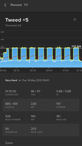

I’ve got Mt Hale +4 queued up for thursday. 4 x 9 @105% with 2 minutes rest between intervals. With a properly set FTP, that’s a stupidly tough workout and only rated as a 6.2. I’m in my specialty phase and I’ve ignored a couple small suggested FTP increases, so maybe the system is really wanting me to train like my FTP is higher even when I know it’s not…
Anyway, I have less of an issue with the workout existing, more of an issue that it’s only rated 6.2. It’s basically 36 minutes straight of 105% with 3 very short rest intervals. 105% is where you’d be doing a 20minute FTP test, so it’s reflective of an absolute max 20 minutes effort(after an quick anaerobic purge). If you are seeing stars and about to die at the end of a single 20 minute effort, I don’t see how 36 minutes at 105% is only a 6.2 rating.

Interesting timing for this thread to come back around. On Tuesday I had 7 minute intervals at 105% on my schedule. I’ve been rehabbing from an injury, so have been sticking to Threshold and below and the 105% seemed a bit daunting to me (not injury related, fitness related)
I woke up feeling fit and fresh so decided to try it instead of switching to an equal PL threshold with lower and longer intervals. Went fine and I could’ve done a fifth interval, which was a pleasant surprise
Haven’t done much training at that % - usually I do longer intervals closer to threshold (102%) or shorter intervals further above it (108-110%) to hit related zones.
105% is a strange area to train - I imagine most of us will end up in VO2 territory relatively quickly there and frankly, having done 28 minutes there it feels like I can probably bump my FTP upwards a bit

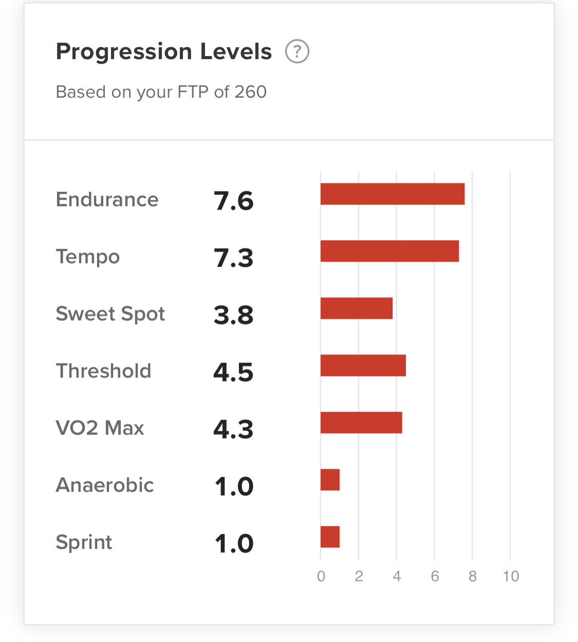

I saw that 105% thing problem on my calendar before. I was around threshold PL of 5 and vo2max PL of 3 at the start of specialty phase(century lv). What I saw on calendar was 105% threshold 10min interval(maybe one of rubicon series) on monday and 105? 106%? same power vo2max interval of 3 or 4 minute. Those records are wiped out because of my vacation annotation, but that’s what I remember. What is threshold workout? What is vo2max workout? That was confusing.
To me, I feel like there’s some steep RPE wall around threshold WL 5. When workout level was lower then 5, 105% interval length is like 6min(ex. TH4.6 Stevens) and it’s hard but doable. As it progress into WL 5, interval length become 8 to 10 min and after workout, I would end up very-hard or all-out survey. AT can make adjustment after I hit “all-out” on the survey, but maybe… workout level tweak on TR side maybe needed for those longer supra threshold intervals as it looks like extend TTE at supra threshold range seems hard one. Tweaking like… extend interval length to 6.5min at Threshold WL 5, not like 8min(TH5.2, Dicks -2) nor 10min(TH5.3, Rubicon -2)
