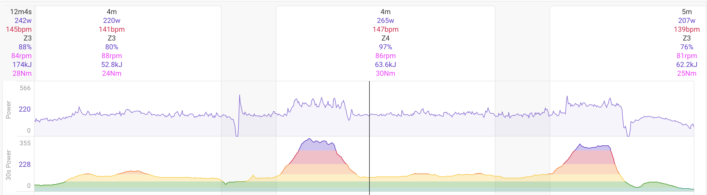

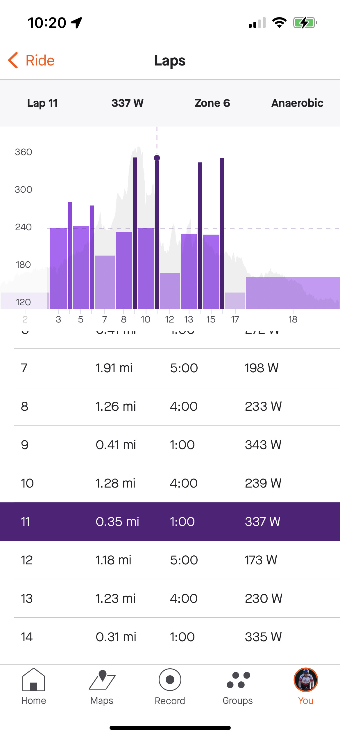

Hi David, tried using intervals again over the weekend and it isn’t detecting intervals the way I would like. Used the Actions > Use Laps at the bottom of the web page. That sort of worked. Two different problems described below:

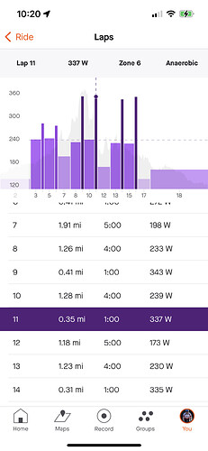

Sunday Actual vs target in Garmin Mobile app (iPhone):
Strava simplified view:

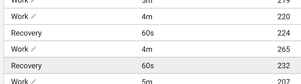

and this is what I get with with Use Laps:
and
Intervals got the correct lap structure, but is not time aligned.

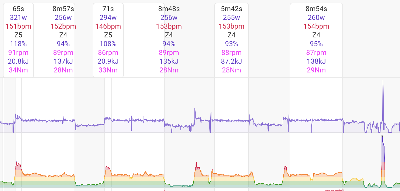

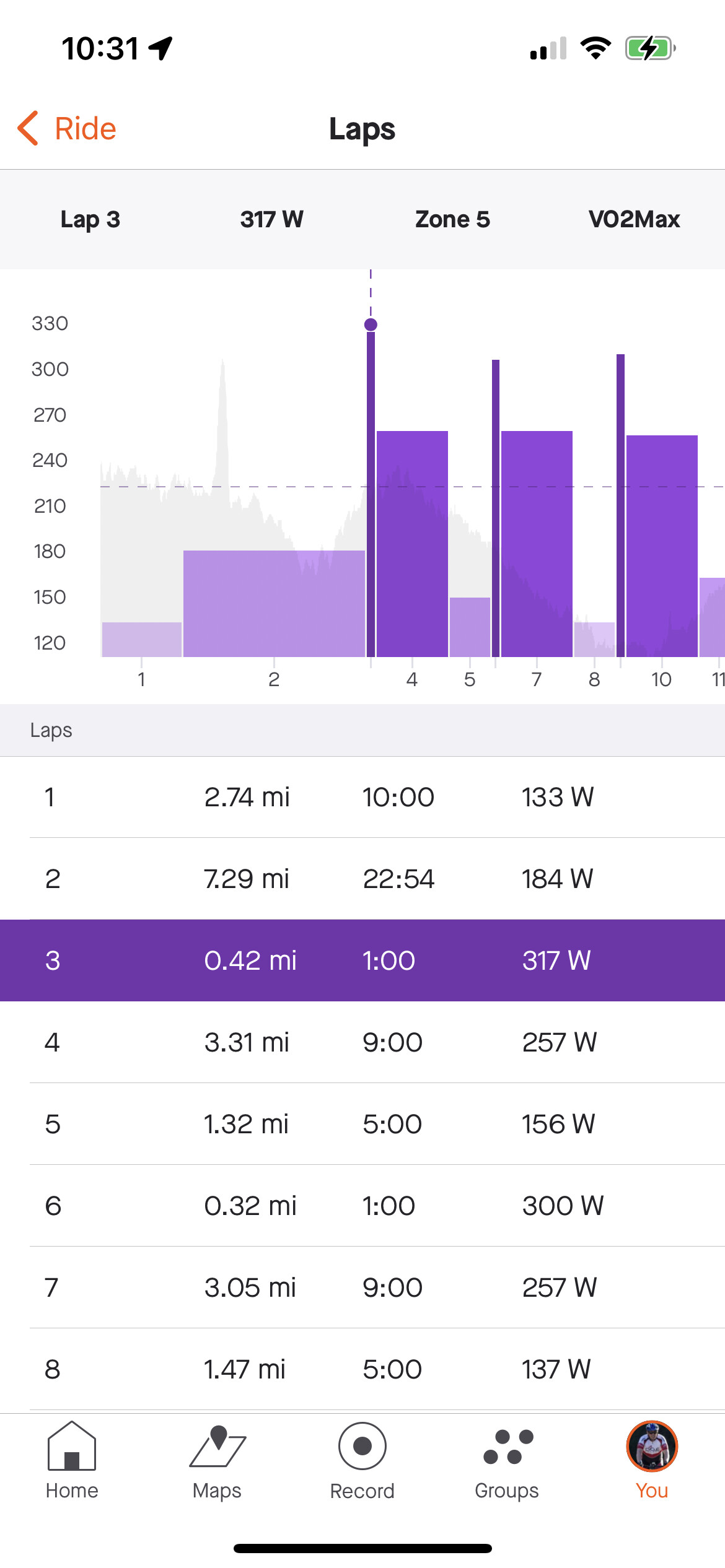

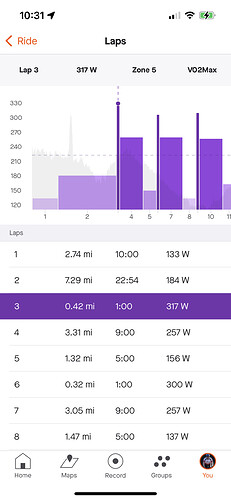

Here is Saturday:
Strava simplified:

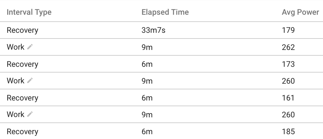

Intervals are 1-min over, 9-min under, and 5-min recovery. Now here is intervals after applying Use Laps (repeatedly). Same thing on iPhone and MacBook Pro:
Lap structure is incorrect.
No problems with those same rides in Strava, TrainingPeaks, WKO, Garmin Connect.

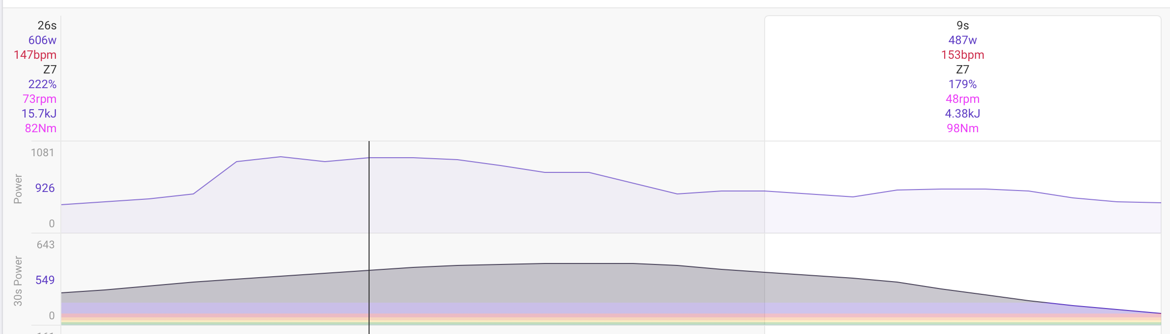

  • it never seems to detect short sprints, this is a season best 7-sec sprint:
Auto-detect instead of laps
  • Note it failed to detect the 1-min intervals on the 3rd and 4th sets. The power drop on 3rd set was at a 4-way intersection, which resulted in auto-detect splitting up that 9-min interval and detecting 5:42.
Unfortunately lap data from the Strava API gets mangled if you have a privacy zone setup. I am assuming that is the problem here because I don’t know who you are on on Intervals.icu to go look.
The auto detection works for nice square intervals without dips and so on. Interval detection was one of the first problems I tackled on Intervals.icu and I could certainly do a better job of it with what I know now. So for those you need to manually adjust by dragging the edges to extend and merge intervals.
For short sprints it expects at least 4 before it starts picking them up. This is to avoid random “non-intervals” in rides that you don’t really care about. You can hover over that position and press A to create an interval there.
