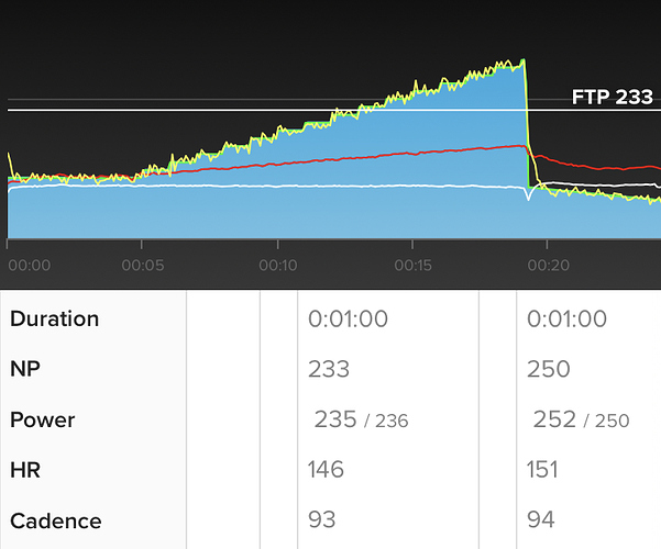

I love hacks like this, just can’t seem to get it to work for me. Making sure I understand what you wrote, here is another ramp test with same result:
  • Ramp test estimated 233 FTP
  • found that interval
  • HR was 146bpm, which is a full 14bpm below my observed HR on hour efforts
Did I misread your procedure?
Or is this another case of HR and Time-To-Exhaustion being more individualized?
