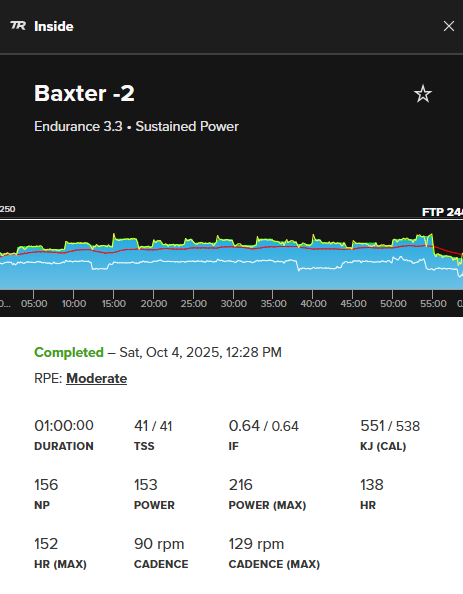

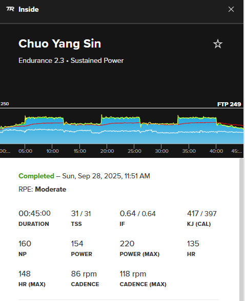

JUst did a 45min easy session Birch Avg watts 157 HR112 compared to 2 other similar in avgs with Baxter -2 being the closest Watts 153 but if you look at HR for all 3, todays is much lower and it felt very easy.
