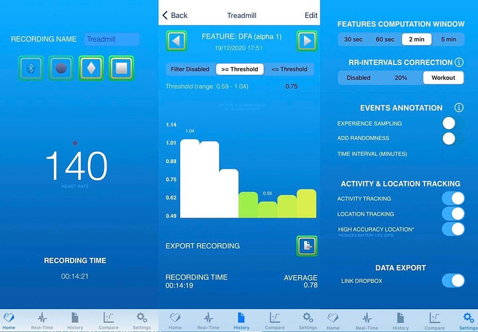

But besides the practical application I just find it interesting nonetheless. Like @ambermalika always in the podcast says that the human body is so mind blowing. Electron transport chain FTW :upside_down_face:!!
It’s early days but would be nice @ambermalika to hear your take on the need of “threshold” concepts for training and if so on some early research using HRV data as (live on the fly) a marker for an aerobic threshold (From laboratory to roadside: Real-time assessment and monitoring of the aerobic threshold in endurance-typed sports - BJSM blog - social media's leading SEM voice)
