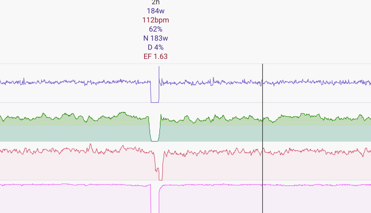

I have a recent 8-min max effort and plucked the 6MMP off that, added a few watts, and Seiler’s rough estimate is consistent with my data.
