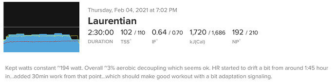

I’ve exchanged some private messages with tshortt on this, and I haven’t found decoupling to be helpful except after restarting serious cycling following my off-season. After 4-6 weeks my power:HR relationship quickly stabilizes and I can show you all sorts of endurance-only, and endurance+stuff going out to 4 hours and decoupling is less than 5%. After looking at decoupling over 4 years I’ve never seen much use beyond that short transition from off-season to training. But everyone is different so maybe it might help you.

ok so re-reading Seiler’s guidelines from FastTalk episode 54 I see him saying 60-80% of one-hour power. So for me right now that is 150W-200W, a pretty healthy range, and yes my endurance rides fall into that range and I’m able to recover. But that is back-fitting his loose recommendations to what I’m doing. I didn’t start with those recommendations by design.
My personal opinion is to go out and ride 65-80% FTP based on feel and recovery, thru some trial&error. Don’t overthink it. Just push the pedals for 2-4 hours and don’t stop unless necessary. Just do the work. If you consistently (week after week) have trouble recovering at 65% FTP then lower it, or pay more attention to the non-endurance work you are doing.

A point I brought up w/ @bbarrera is I think different coaches have different ways of using the concept of decoupling. Perhaps because of Friel covering it in one of his books, and also perhaps due to guys like Seiler using it to explore his low-intensity durability concept, we tend to focus on decoupling as it relates to long-steady low intensity riding. Moreover, when we do observe it (even when controlling for all the shortcomings @Bbt67 alludes to), figuring out what it means or more importantly, what can I do with this information to improve my training is not definitive. Coaches and thought leaders are taking educated guesses, but it’s not set in stone. Do I cut the ride when it happens? How much is too much? Do I let it go a bit to “do some overload”? Am I chasing windmills? But those question just apply to using it in that context.
There are other ways that you could use decoupling that seem to provide actionable intelligence that have nothing to do with long slow riding. For example, I’ve seen a coach use it more during tempo work and is absolutely dismissive of looking at it for LSD, and he’s definitely not a “power for all the things, HR is redundant” kind of guy.
Maybe decoupling is not the best term for all use cases. At least some will look at HR response both near the end of a power prescribed interval, and during the recovery interval.
Sure my all day pace is upper 130s bpm. I’ve loosely used that for pacing long days on century rides. And looking back those resulted in (roughly) a range of .65-.80 IF.
Yeah, like @bbarrera was saying. Yeah, definitely those situations.
Sure, HR response. In those cases that may be a better term for it. However, I have not seen a use for HR alone that isn’t redundant or useless (useless now that we have power). IOW, when it’s useful, it is useful as it relates to power. It’s coupled with it, or not, to varying degrees. In your example (and it’s a good one), we’re still not looking at it in a vacuum or isolated.
