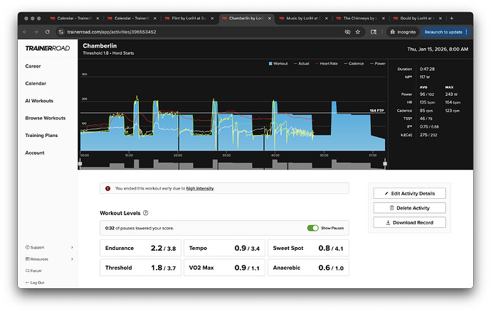

  • There were no indications from your power data over the last 90 days that your FTP was at 154w in early January. When you had your FTP set to 154, the model was trying to give you the easiest workouts it could find, but they weren’t easy enough at that high of an FTP, so you failed 4/4 hard workouts in the space of 2.5 weeks.

Going back to the week of January 5, your FTP was set to 154 and you had 4 workouts above endurance between then and January 21 (when you accepted the 113 FTP from the new version of AI FTP Detection).
Here is the report on those high intensity workouts:
At this point the model was trying to do it’s best with your training, but for every hard workout you had, which were all toward the bottom range of difficulty in those specific workout categories, you weren’t able to hit your targets and/or needed to turn down intensity. These are all signals that your FTP is too high.
Further, looking at your recent power records, in the last 3 months your highest 20min power has been 139w, and your highest 60min power has been 127w.
