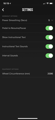

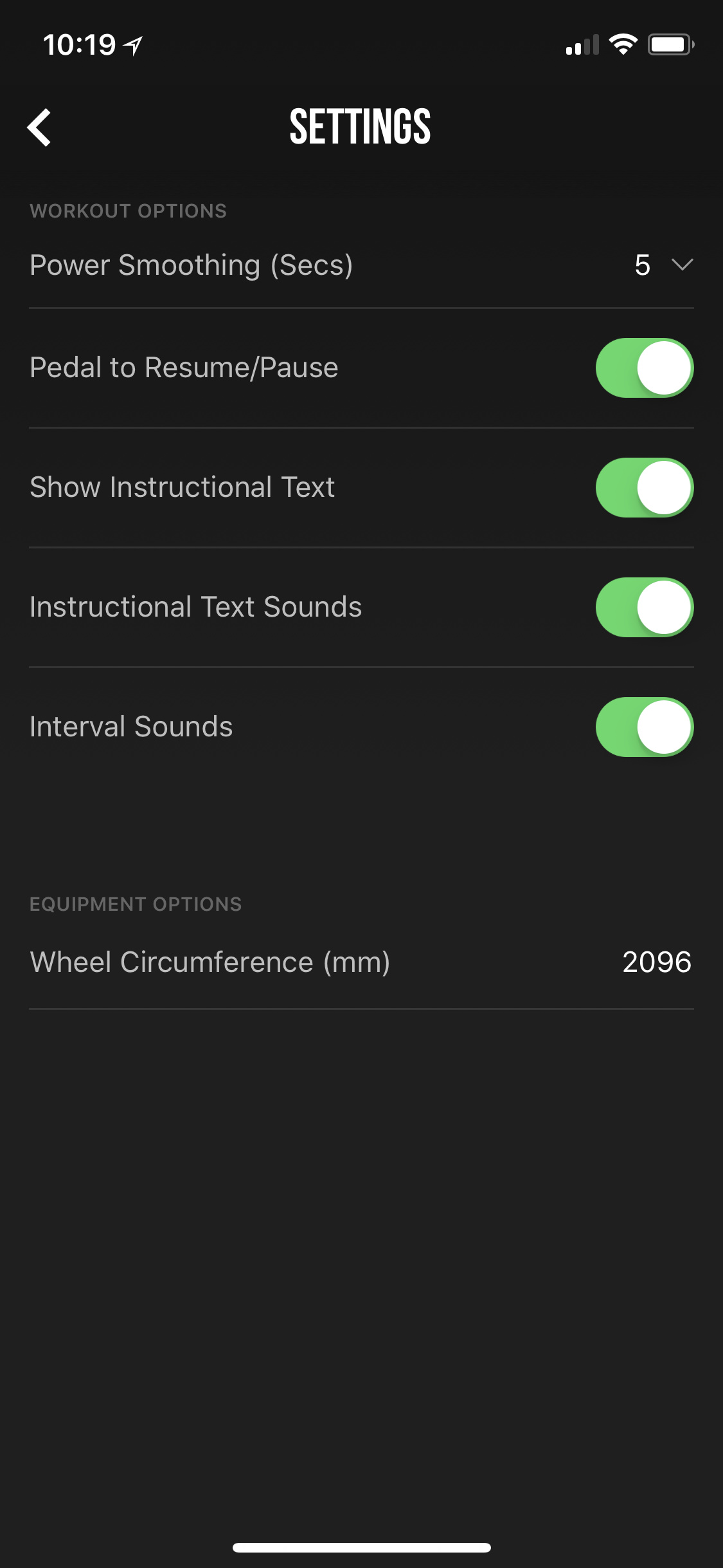

How does one turn it off? I felt the same way. As I approach a new FTP the words pop up that make me feel like I’m lucky to be alive at this point and I can totally feel the energy levels drop.
Just turn off instructional text in the settings
