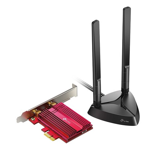

Alright, update for anyone who stumbles on this in the future:
I solved the problem!
So thankfully, because I’m one of 4 people who still have a desktop computer, I was able to buy and install a PCI-e wifi and bluetooth card, specifically this one:
Now, to be clear, this is a bluetooth 5 card, but none of my devices are bluetooth 5. Previously, I was using a USB bluetooth adapter, as well as a USB wifi adapter, in my dekstop, and my macbook of course had bluetooth built in.
I’m not exactly sure how this is fixing the problem, but I suspect the bandwidth is the reason. Anyway, today I had a rock steady connection to BT using my Kickr, BT HRM, and BT headphones. All went well.
