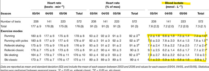

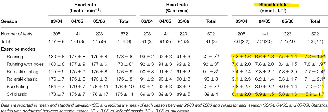

No, it’s more complicated. For many elites the gap between LT1 and LT2 is very narrow. For elite marathoners it’s almost identical. ISM says Pogocar never gets high La levels. It’s a characteristic for elites and Pog is an extreme. Blu and Iden do their endurance < 1mmol. This is far away from >2mmol. And the type of sport makes a difference, see his example on marathoner vs middle distance (or so) runner. Finally, he never specifies how he determines LT2. There are a dozen of different definitions.
As alwas, context is important. However, the key is, he advocates a different model to what the Norwegian Nordic skiers do. Here La levels for their typical intensity training
Karlsen et al. (2020)
