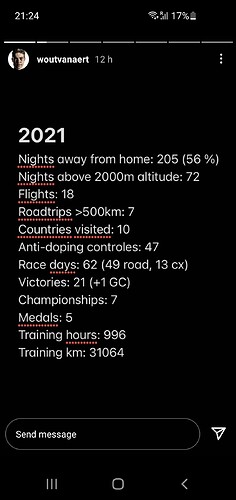

He has had 21 wins. This means a test after each of them. Then many races require a pre-race medical examination which includes a doping test. Then, I don’t know how often he wore a leader’s jersey in a stage race but this would add to the number of controls, too. If you combine these in-training tests may not occur so often. And this is where the stuff is supposed to work. No implying anything but in-race testing catches only the dumb (and/or desperate) riders.

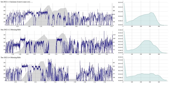

One of my favourite riders (because he gives hope to all of us who are caught in sprinters’ bodies but want to do fine in mountains/all-round): S Colbrelli
Since Dec 27 he’s on Gran Canaria, quite a package. And almost always some stuff within these long rides. So much to base is easy, strictly below LT1 all the time:
Super interesting to look at his last few weeks, lots of stuff ~90% (assuming his strava 421w FTP is correct). Almost all of those 90% blocks have some low cadence work, his ride on Dec 21 for instance has 2 20 minute blocks around 250-360w, a 5 minute and a 16 minute also around that power. Each one he seems to alternate between 70 and 50rpm every 2 minutes or so.
Another thing I have noticed with him in particular is a lot of his rides end with a 10-20s sprint effort, this last sunday is an example with that same 2x20 and a sprint at the end.
This is typical Italian approach, like Michele Ferrari describes on his website: www.53x12.com. Activate faster fibres at low cadence then increase cadence to use that fibres in more agile way. So basically you train faster fibres without going over threshold.

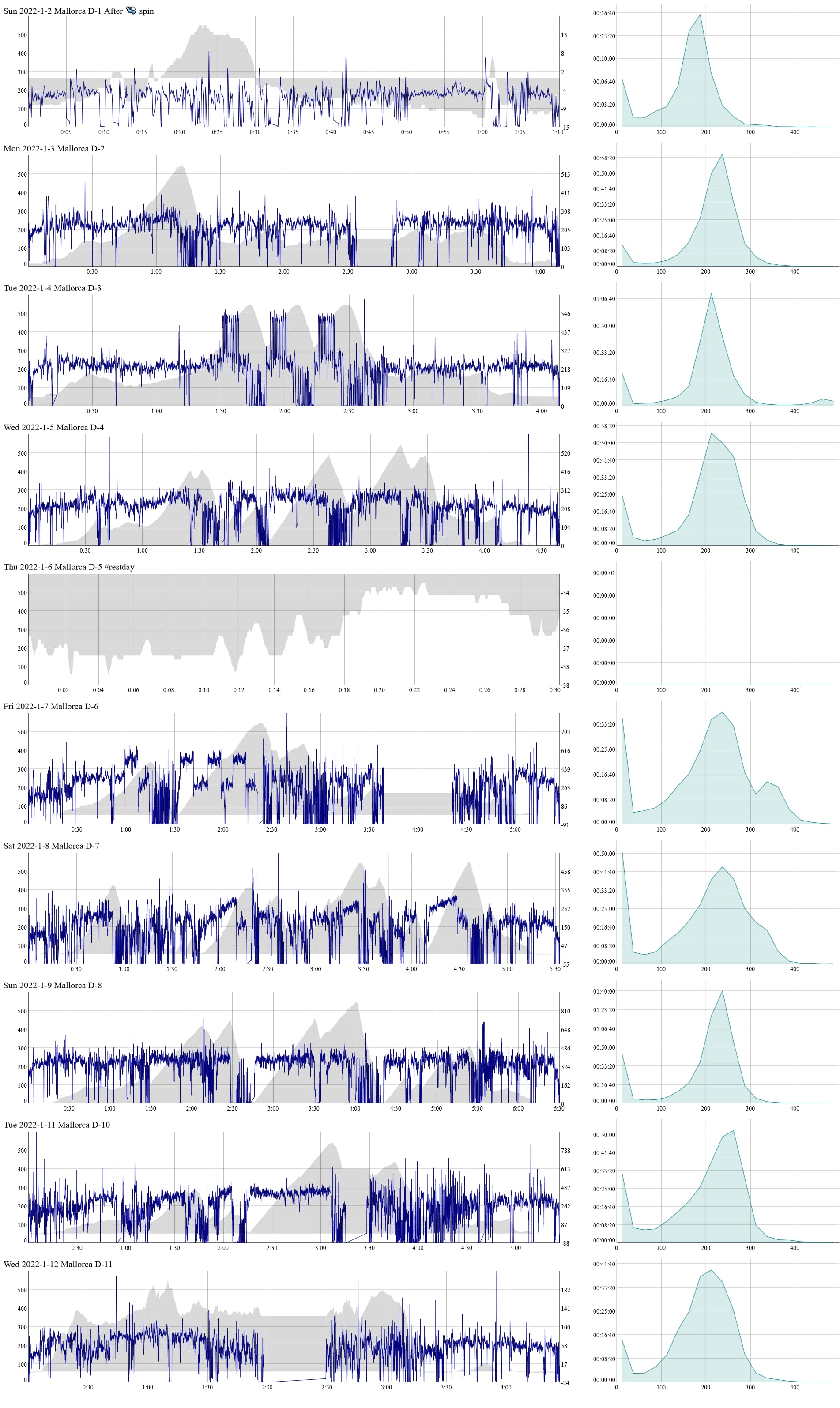

Emanuel Buchmann - January so far - quite a package. And it is very obvious that they work on his limiter: being a pure diesel. The frequency of intense stuff is pretty high. Is this what is need to add turbo to the diesel? And Dan Lorang clearly reads the science, Jan 4h is Vaccari et al. (2020).

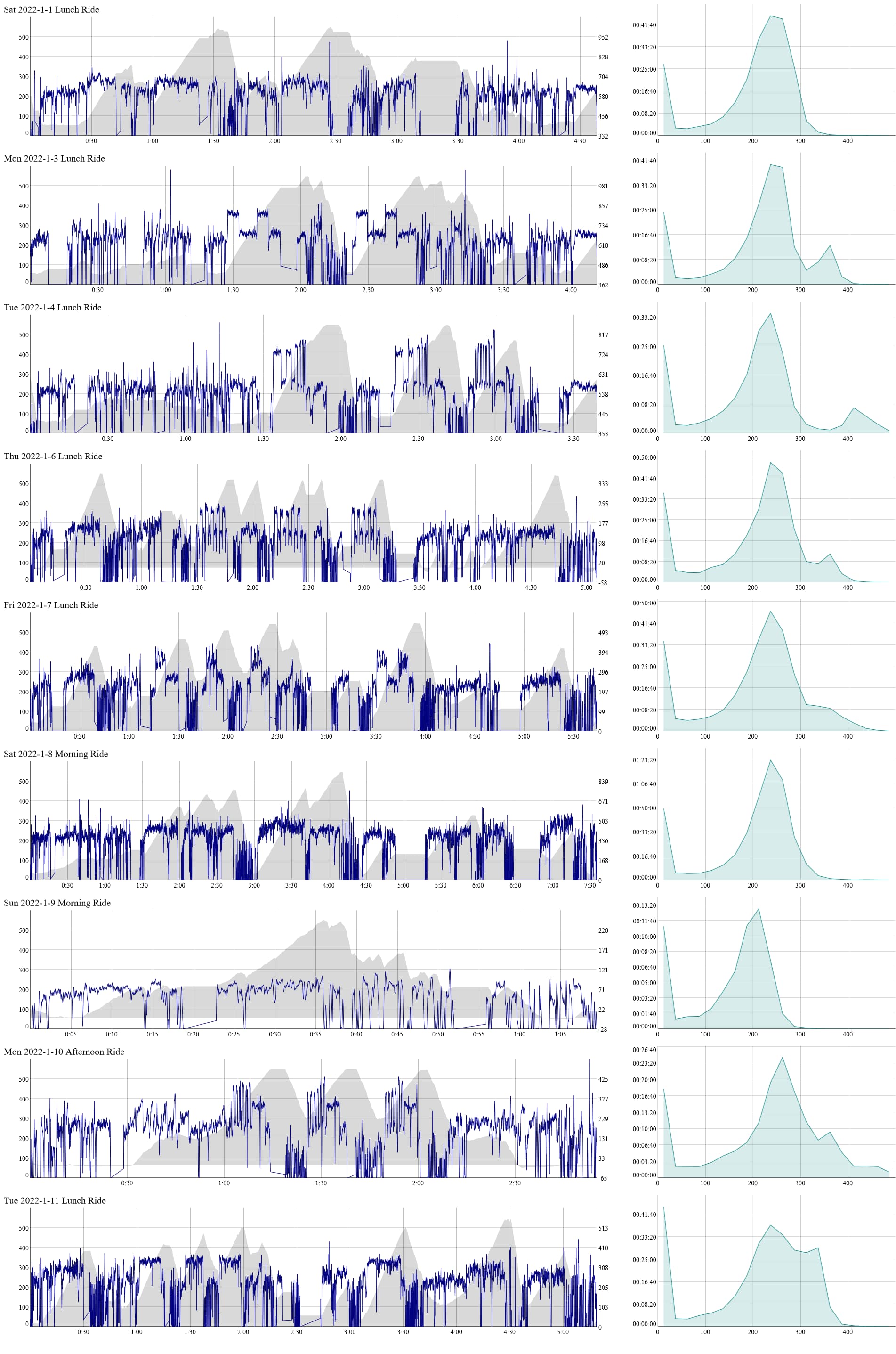

McN watch - Jan 22 so far … Zone 2 building base phase is clearly over. Rides are shorter with more intensity. Just some ISM Zone 2 maintenance sessions
yesterday’s session, uffffff, almost 500W for this first 10min effort. And then still enough power left to do a sprint. However, not enough to take the Girona climb KOM. Still, this is where you see the difference to mere mortals. 500W for 10min at this weight!
