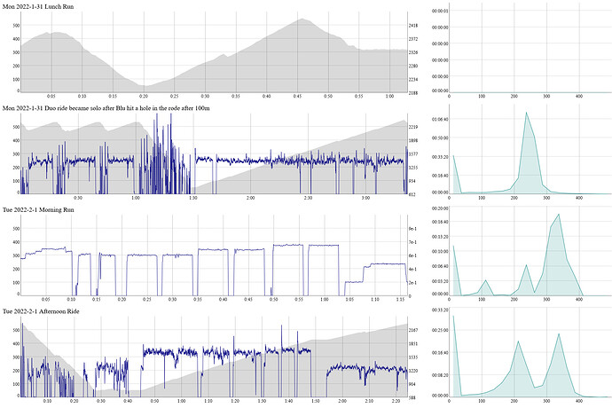

Blu: “LT2 push”. Iden’s watts from today, it seems it is one of those double threshold days. Run first, then a ride. W/r to absolute watts, this is at altitude.
Oh no !!!
