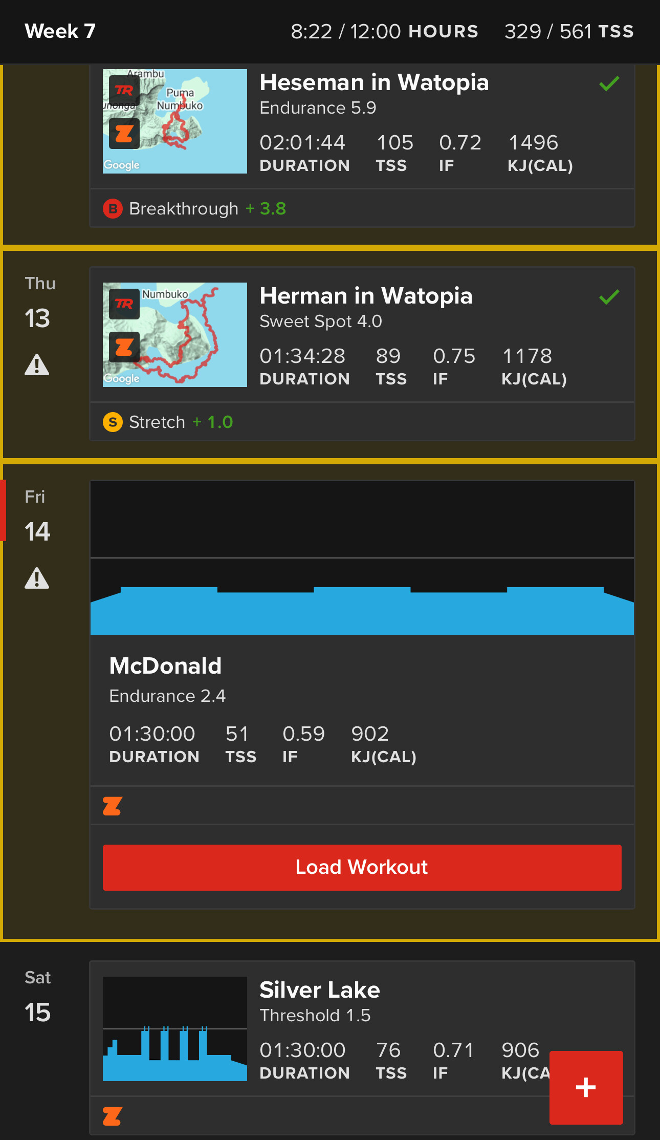

Yup that’s what I mean. TR has my 14 hour week last week and the 13 hour from the week before etc.
Here is todays and tomorrows supposed rides the ai wants me to do.
A PL2.4 and a threshold PL1.5. Both would be way too easy but I suppose I scared the ai by doing the 5.9 endurance ride.

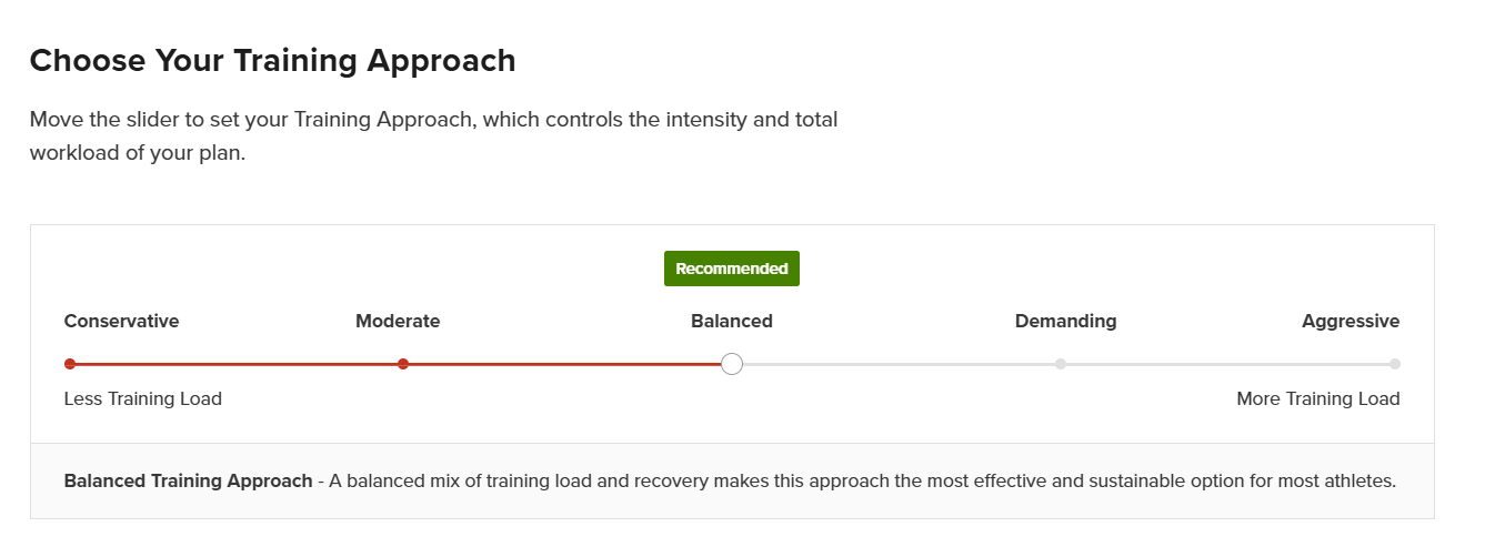

Your riding history, back to only November is likely insufficient for the Red/Yellow light system to work as you’d hope and is (rightly) being cautious and giving you these endurance rides. Two recent weeks with many hours is not enough to show the system of your long term training load capabilities.
Now you can tweak how conservative this is and will have seen this screen setting up a plan.
Perhaps you could dial this is up and see how the software responds?
This can be changed outside of plan builder here

I’ve complained about how useless the low PL workouts are for a while. It’s absurd that the Silver Lake workout in your image is even offered.
For context, before PLs existed, the entry level threshold workout was Starlight -2, which is still pretty easy, but a much more reasonable starting point I think. If it were me I’d use that to replace Silver Lake on Saturday. That will give you an idea of what over/unders feel like (if you’ve never done them before) and hopefully get the AI to stop wasting your time.

The two weeks is just an example. I’ve had a high load since December once I had my legs under me. For the training approach I set it to aggressive when I first started the plan.
