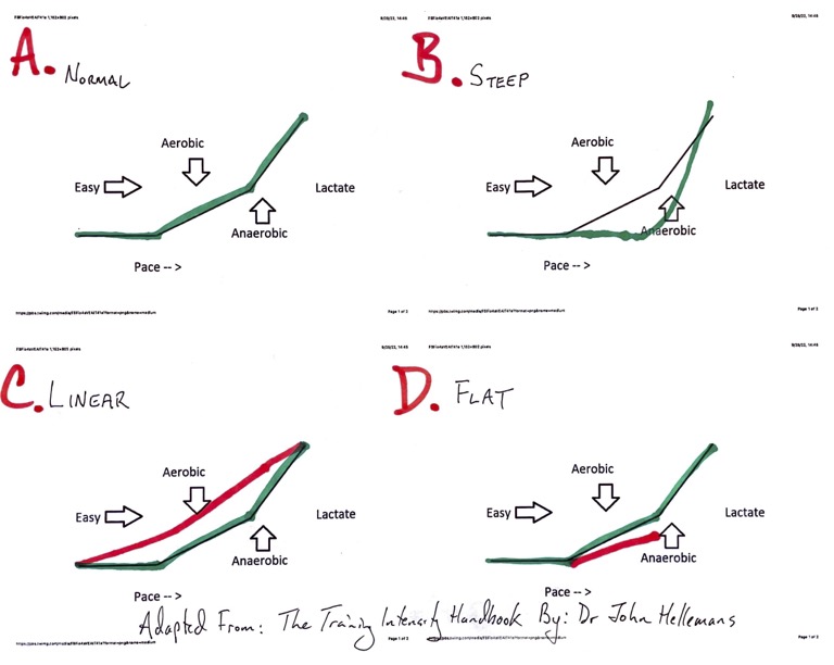

Do a few more steps and see the curve!
And also your case is a bit common, google aerobic defficiency syndrome. I see that in “no structure” trained atlethes where they are spending a lot of times at “happy hard itensity” and that is around 2.5-3 mmol of La so they are producing Lactate with anaerobic engine almost from the easiest power…
