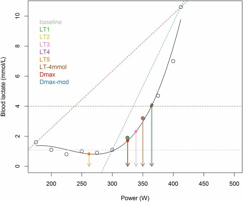

La will often drop with the first few steps in a graded test. Only if you’re really unfit it will rise immediately. A higher value at rest is not unusual, your 2 mmol seem reasonable.
Taking a sample from the finger reads ~0.3mmol (on average) higher than from the earlobe.

Example for this slight decrease initially. And this is lab grade ear testing … i think
