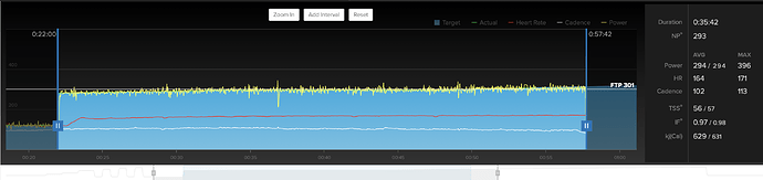

Well it depends how recent the performances you failed to beat were. If you’ve got a better result for 35 or more minutes in the last few weeks, maybe go with that as your FTP. If 294 is the best you’ve done recently, then stick with that.

Q: post-test, what to use when structuring ensuing workouts – WKO TTE or TTE test results?
Same FTP/mFTO but WKO runs shorter than actual conducted test TTE.
From the ‘what workout today’ thread I think you did 60 minutes at FTP? Is WKO within 5-10 minutes of that? I’d say its your choice, but I might go with the more conservative and then during an extensive phase extend duration during actual workouts when I’m feeling strong.
How much shorter? I’m no expert, but if you actually rode at about FTP for a certain length of time then I’m not sure why that would not be a valid measurement of TTE.
It’s doing a regression on the data. The math means that it fits under the curve instead of over. It’s generally just a minute or two under what you did.
Ahh okay, I’ve never used WKO stuff but that makes sense. I guess they would prefer that the measurements be just a bit on the conservative side.
WKO is pretty close on my long rides at threshold, for example 51 minutes at FTP and post-ride WKO updates to 47:07 TTE. Or 65 minutes at FTP and post-ride WKO updates TTE to 56:42. Really depends on the shape of your curve, and interesting things happen if a really strong short effort falls out of the 90-day window.
I didn’t think of WKO using data other than just FTP intervals to come up with that TTE number but that make sense.
It’s a difference of 20min(!).
My previous TTE test was 35min; WKO TTE ~30min; same FTP.
From TP: TTE can is visually represented by a vertical line just after the kink or decline in sustained power outputs.
Except there was no decline in power @ ~40min; there was an incline in power.
(do I have to “feed” the model more?)
Would have to look at your curve. But if you don’t have maximal efforts on the short duration it messes with the long duration stuff as well.
