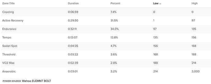

Just for reference, here are two outside Z2 rides I did solo. The outside ones take attention along with generous use of gearing & cadence to hold the power range both up AND down (note the minimal coasting for 3.5 hours rides). This is NOT something that is achievable in a group setting, even when I do it with a small group that actually knows the objective and generally sticks to that vs the typical “group ride” that is a smorgasbord by comparison.
