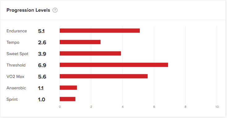

I also got this but yesterday my Sweet Spot PL was 3.9:

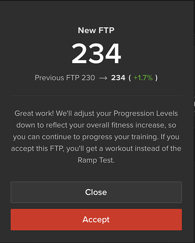

So I have been avoiding FTP tests for a bit, since I had a move from Italy back to the US, and some life changes etc. Then I started another block of training and have been crushing it pretty hard.
FTP Detection said I was at 303 from 295. So I accepted. Then it hit me with Septeret.(Log In to TrainerRoad)
I was able to pass it… it hurt, but these are supposed to hurt. I’d say the detection is pretty spot on, if I could complete this workout. Agreed?
