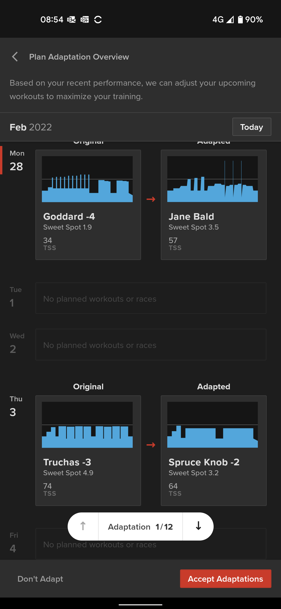

You are not the first person to mention being given an incorrect adaptation here.
Just to add a data point my Goddard -4 was adapted correctly to Jane Bald which is a level 3.5.
