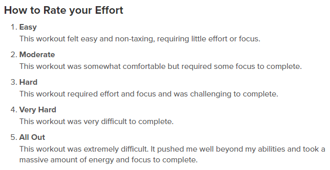

That’s pretty much how 2x20 at 100% threshold should feel…not max max effort…but not fun and glad it’s over…at least that’s my experience/view
Would you say it might fall into the “Hard” or “Very Hard” rating if everything is aligned properly (FTP, rider prep, etc.)?
Yes I would. Not all out but feel for vast majority it should be either hard or v hard. Exact one depending on fatigue on the day, motivation, caffeine etc AND experience of doing longer threshold efforts.
OK, that was my thought too. Good day could be Hard, and off day maybe Very Hard.

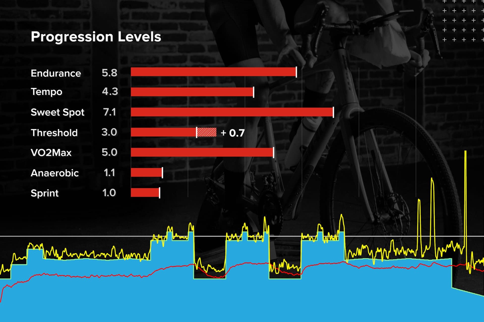

I’m not sure I see the point of threshold progression levels below 4.1 and above 7?
It seems like the workouts within this range are the ones that most would agree are the traditional threshold workouts based on %FTP so why not just set the athletes FTP so that they always inside that range?
I.e. after every FTP update an athletes progression level should be between say 4 and 5 and if they get above 7 they should retest or receive a new AI FTP.

Reference - PLs before 5% FTP detection increase:
After:
(as an aside - seems odd that tempo and threshold dropped a lot, but SS zone in between them did not?)
