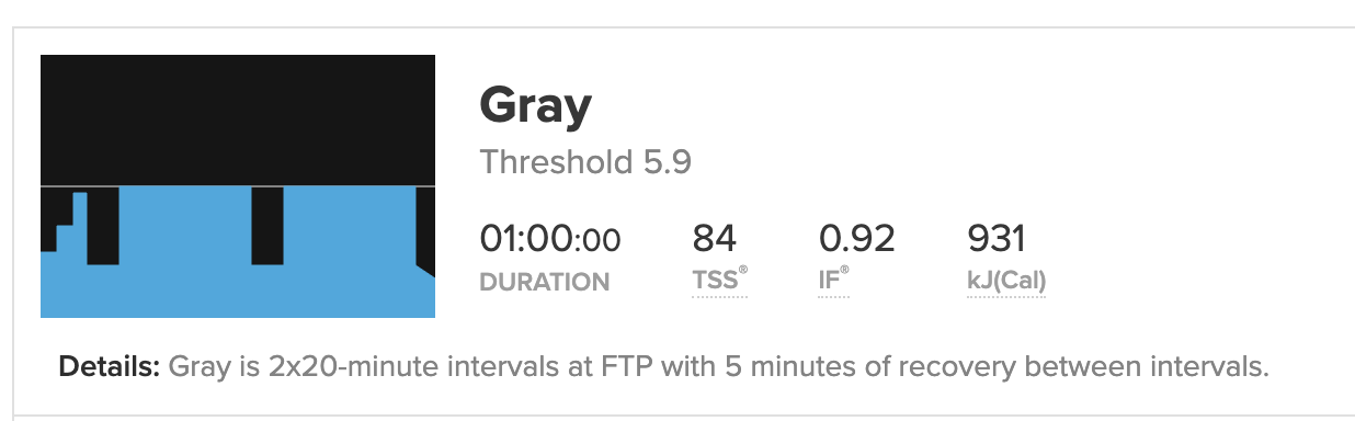

Looking from outside… Many use for example 2x20 threshold as kind of bread and butter that should be achievable on any “correct FTP” and that you should not be needed to build into that FTP by doing 5x6min and so on… I speculate that’s @Bbt67 point.
It then becomes more training philosophical debate I commented about here:
I’m all for longer intervals but TR is more on the other side of the table (and I can think of reasons why so…even if it’s not my personal choice):
So that’s a 5.9 level workout.
Based on an FTP of 249 and a threshold PL of 2.4, you’d have to lower your threshold to 233ish to complete this workout.
This isn’t exact but I think it’s pretty close.
