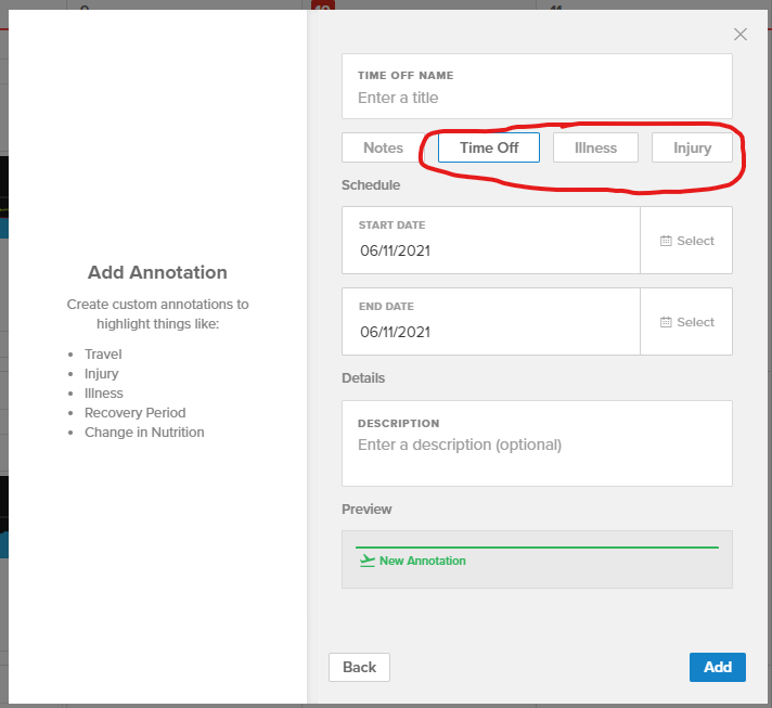

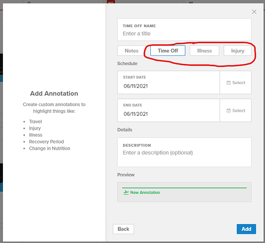

Use the Annotation feature and select Travel, Injury or whatever you want. Set the dates and click save. It will then ask if you’d like to recalculate the plan. If you hit Yes on that, it will then change up your plan to account for your time off. In some cases this will simply be removing workouts and dropping levels for the workouts when you get back to account for your time off the bike and decayed fitness. In other instances of lengthier time off, it may give you a whole new block progression.
Add an Annotation to your Calendar and select Time Off, Illness or Injury as appropriate. Set the days and such, and once you accept that it should trigger Plan Builder to adjust as a result.

This is great - thanks for posting this. And just for further clarification, if one just misses a day (i.e. planned to do todays workout but life happened) should one use this method or just miss it and let AT and/or plan builder do its thing?
AT will adjust if you skip a workout without using the annotations feature. I’ve done so without issue. The annotations are generally for planned time off, but could be used in the way you describe and still be effective, so either way will work.

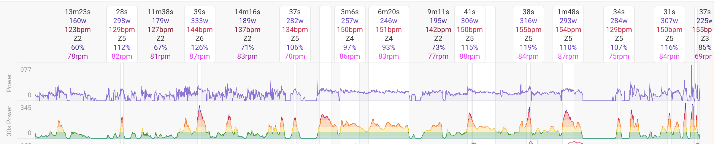

For unstructured rides, like last night’s Wed worlds, I’m not sure what to think of intervals.icu:

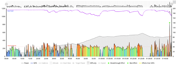

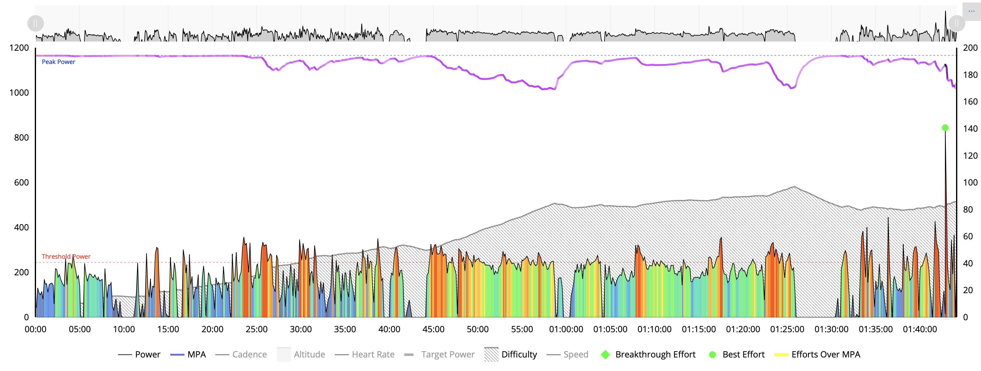

while Xert classified it as 10+ minutes of climbing, and a difficult mixed climbing ride. Here is a pretty picture without the text stating it was 10+ minutes of focus on climbing:

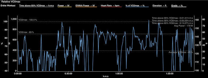

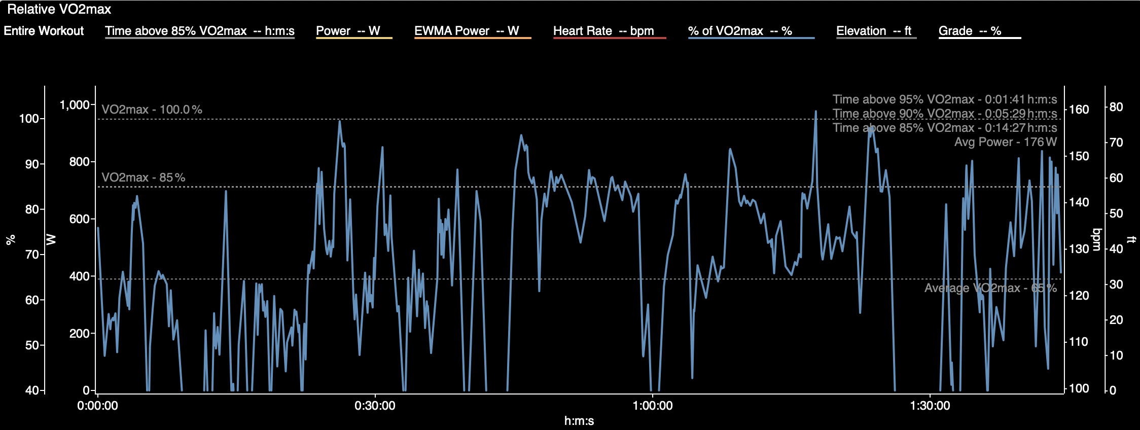

And over in WKO my interest was relative % vo2max as I simply wanted to accumulate some time above 85% vo2max:
14 minutes on Wed and 10 minutes on Tue, not too shabby.

Here are the work intervals detected by intervals.icu
Simply scanning down that list:
  • for z5 I don’t see anything 2 minutes or longer. Hard to see that moving the needle on vo2max progression level
  • for z6 there is one effort and barely anaerobic so hard to see it moving that needle
  • which brings me round to z3 and z4, which if you loosen things up there is a longer interval to suss out like I did in the TR screenshot above. So that seems like enough stimulus to count toward something
