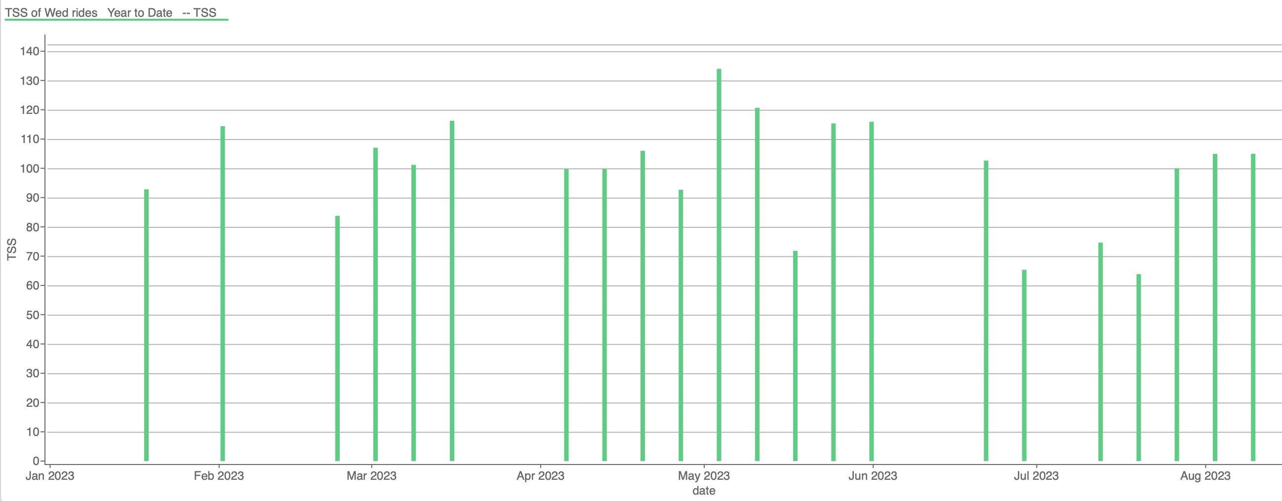

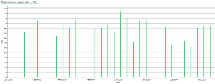

Here is one of my better self-coached years, TSS of Wed group rides:
nothing in January, and I cut the graph off at end of October. Most of those are 90-120 minutes, and during the rides under ~90F / 32C the IF mostly around 0.9 and I made the group/drop ride “progress time at threshold.”
Again, self-coached. If you are focused, and have decent terrain, pretty straightforward to progress.

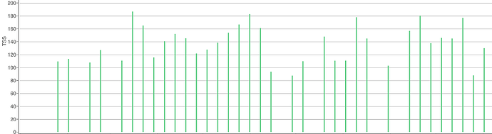

This year, under a coach:
similar goals as previous year, struggled with recovery issues this year so lower IF. But similar pattern of progressing time at intensity / TSS. Was really starting to hit my stride again in May, felt like I could have pushed back into weekly rhythm of 120-150 TSS riding at high intensity but developed an issue with my thumb/elbow and lost my focus. Held fitness this summer despite dropping hours quite a bit.

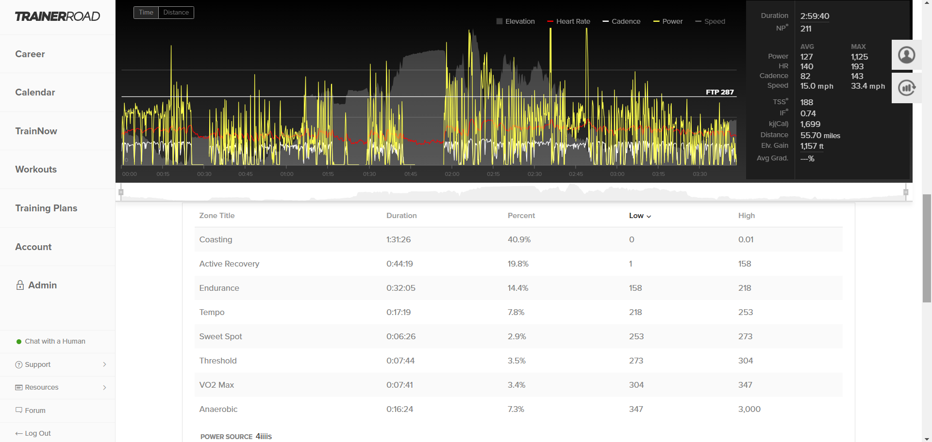

@Abe_Froman & @WindWarrior,
Something to consider with group rides is that each of the different riders can have different body weights, heights, CDAs, FTPs, etc., and training together on the same ride will have extraordinarily different effects on each of them. We all live different lives and have unique strengths and weaknesses, so progressing a group ride won’t have the same effect on all riders.
Rides without structure can also often have a ton of time coasting or at really low intensities, which isn’t really productive.
I saw that you shared your calendar on the forum recently, and the example below is a group ride that shows almost 60% of the ride either coasting or in active recovery.
The reason that most current top-level professionals do almost all of their training alone is because their plan is tailored to them. If they want to train specific systems that help make them faster in race situations, such as fat oxidation or lactate clearance, then they need a specific workout tailored to their unique physiology to achieve that. This is why we recommend our plans, Adaptive Training, AI FTP Detection, etc.
