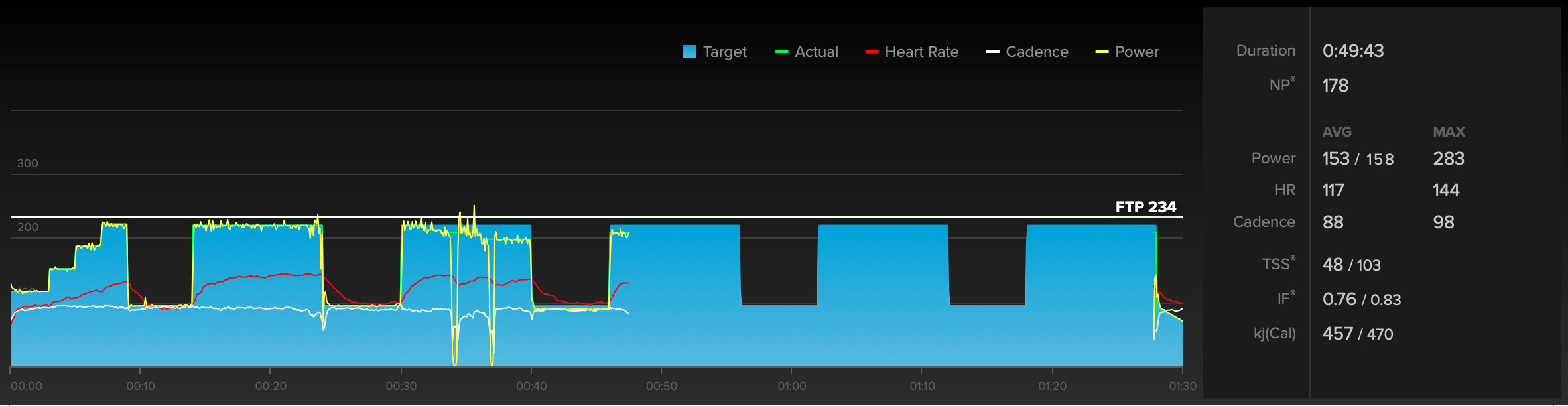

The 1st week of SSBHV II went quite well - marking the SS workouts as “moderate”. In hindsight, I should probably have marked the Saturday ride as “hard” as I had some soreness into Sunday and found the long Z2 ride a bit harder than expected. Was still a bit sore on the day off (Monday.) I woke up Tuesday feeling good, and jumped into Great Knott which was a large jump in WL. (7.8 up from 7.2 the week before.) I knew this might be a bit on the difficult side and would not have been upset to not complete it. But I struggled in the very first interval, and took a planned short break in the middle to calibrate the trainer. I then had to backpedal twice to make it through the 2nd interval. 3rd interval was lower in intensity but I could not maintain cadence. At that point I gave up, and let AT do its thing. And if that had been the end of it, I’d not have posted.

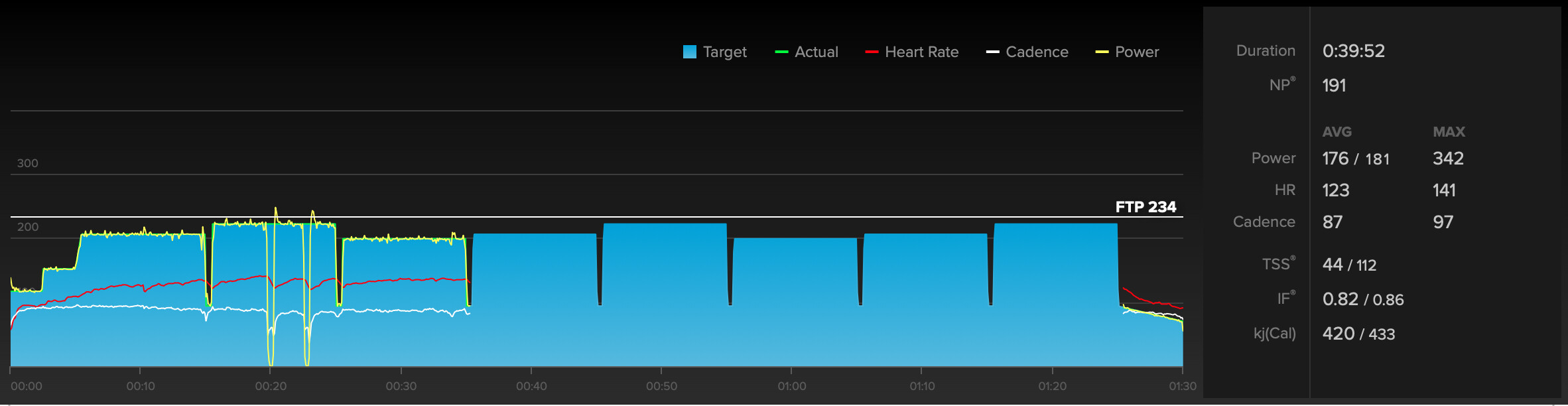

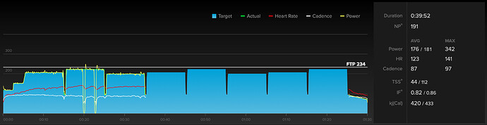

On Wednesday I did my low Z2 ride and felt fine. Today (Thursday), AT gave me Antelope +2 which was only WL 5.9. I figured that should be a good workout that should be easy to moderate based upon last weeks rides. I was quite wrong. Finished the first 10 min interval at 94% and was surprised by how hard it felt. I then backpedaled 5 minutes into the 2nd interval and lowered the intensity a few %. 3rd interval still felt hard so backed intensity down to 90% and my legs just had nothing in them. I bailed again, but at least did a bit of Z2 afterwards which felt ok.

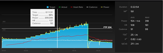

OK - took yesterday completely off the bike, and only did a very gentle 1 hr z2 on Friday. Woke up this morning and did the dreaded ramp test. It showed that I’m ~10% down

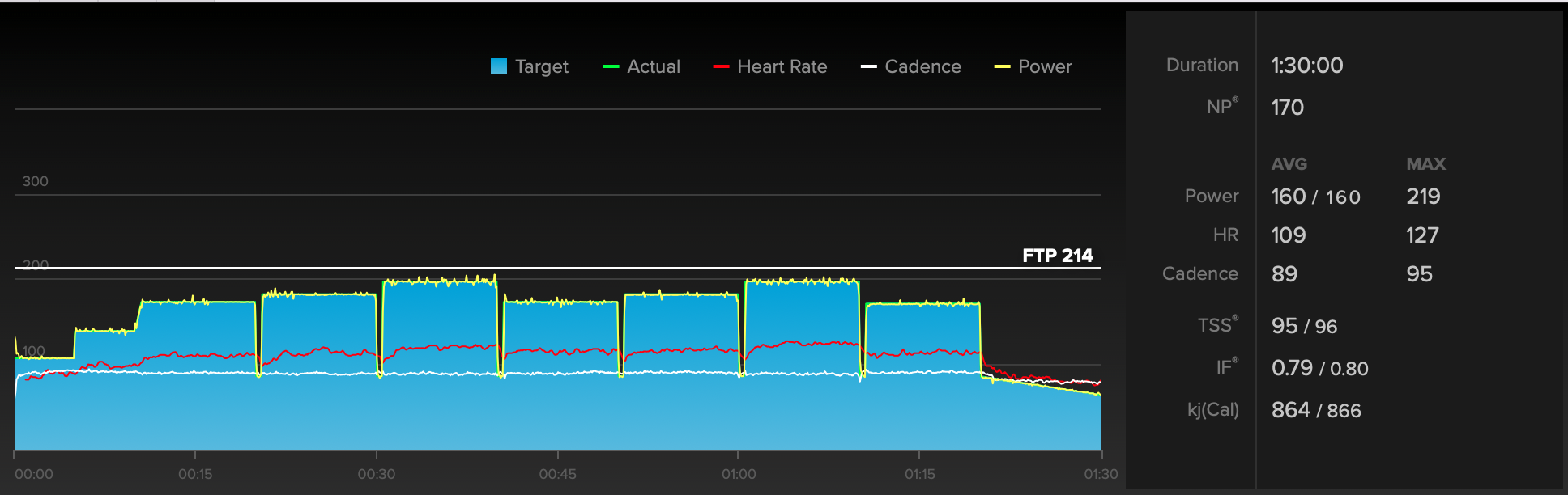

Just an update for those that are curious. When I woke up this morning AT tried to adapt Black Lassic (SS 5.9) to something that was 4.2. In the past, I’ve consistently accepted AT’s changes, but at the new lower FTP, I knew that Black Lassic would be quite achievable. And indeed it was:
I rated it moderate, but gave some thought to calling it easy. I thought I might even increase the intensity in the 2nd half, but managed to restrain myself.
