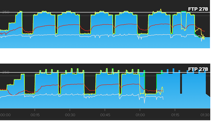

For what itās worth, I can attest to the fact that this workout has proven to be the most difficult workout Iāve done in my 16 months of diligently doing TR workouts. Sure, I technically completed Spencer +2 though it was not without first dropping the intensity of the third interval by 10% followed by a previously unheard of drop in intensity of 20% for the final three intervals (effectively making them each FTP-level) to which I could STILL barely hang on to the end of each of the three minute intervals. All the tell-tale signs were present: cadence falling precipitously; heart rate nearly to the max; and eyes staring at the timer to see if itās still working
Iām sure thereās a number of factors contributing to my poor performance with Spencer +2 and thatās another matter for another day. In the meantime, Iāll be hoping you fared well in your recent attempt and will be looking forward to both of us one day solving the 6x3-minute VO2max repeats at 120% FTP completion mystery that at this point so far seems unsolvable. ![]()
[EDIT]: hereās a screenshot of Tuesdayās date with death (aka Spencer +2)
