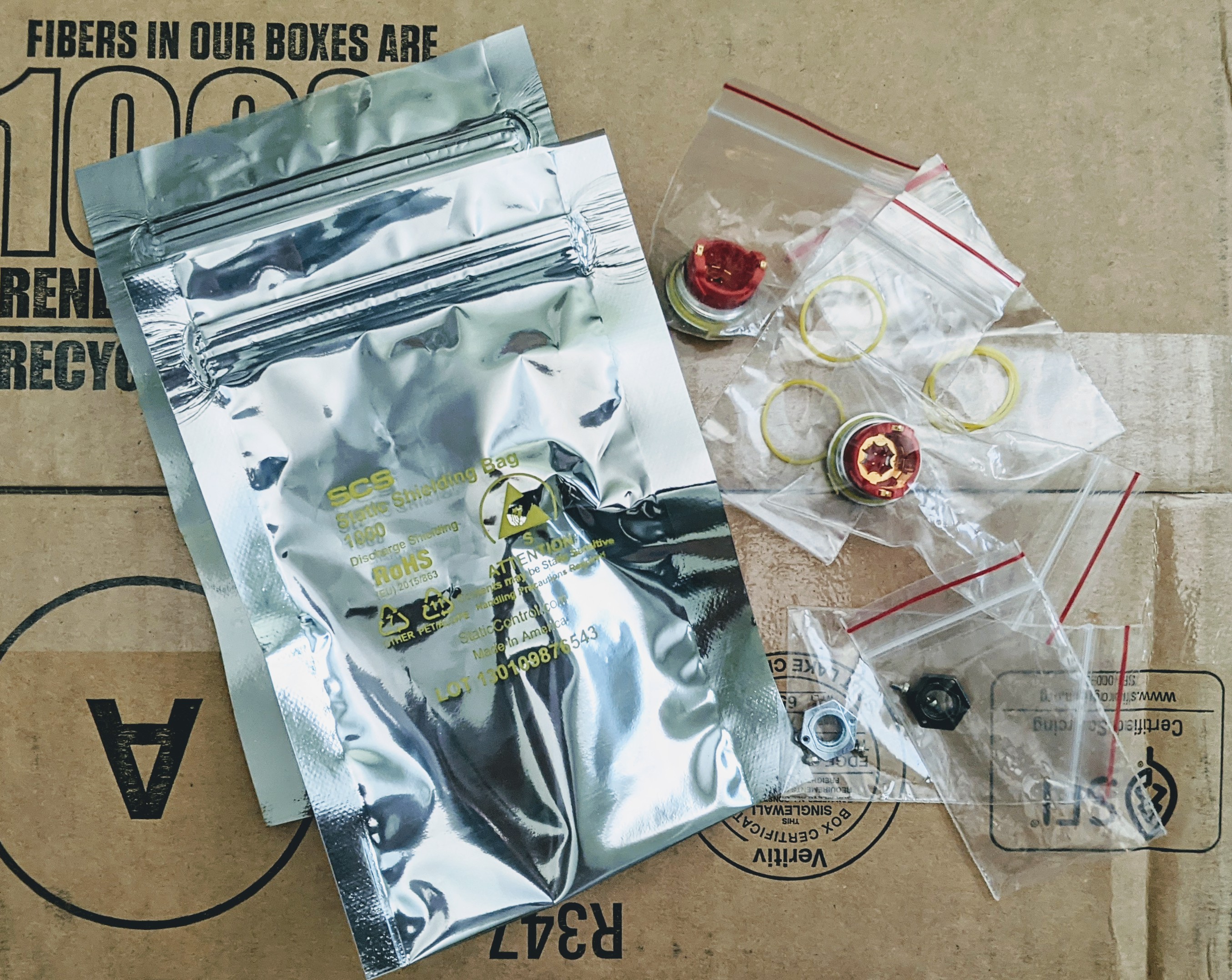

I’ve had an XC conversion kit on order for use with my existing Vector 3, it’s been on backorder for a while now and kept getting pushed.
Over the weekend, I saw that XC Rebuild Kits were in stock (One for Left Sensing, and one for Right Sensing). $100 per kit.
I went ahead and ordered.
They arrived today, and conversion was easy.
Each kit included the pedal body (with new spindle seals), a battery door, a battery board, 2 door o-rings, and the spindle nut/tiny screws.
I think the official conversion kit includes pedal washers, but I do not need those. Otherwise I see no difference in terms of what is included.
Cost for the actual kit was $250, so in addition to getting the parts earlier, there is a $50 savings as well.
