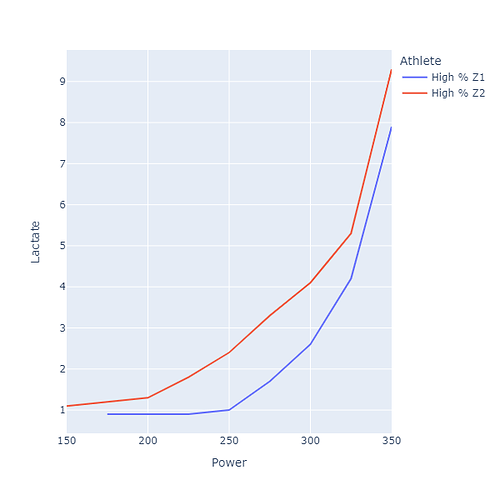

Alan Couzens has a blog and frequently posts about training zones on Twitter. For example lactate curves for 2 pro triathletes with one training upper z1 and the other upper z2:
A lot of food for thought for IM training. You may not agree with him, but reading the posts and discussion is interesting and thought provoking. And his website: https://www.alancouzens.com
