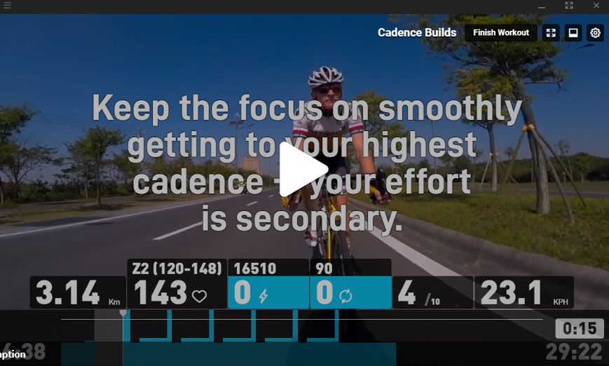

I actually signed up to this. The 4DP profile had me at 250W FTP which is 50W lower than what I was currently using on Zwift. After swallowing my ego and moving into the workouts I found them to be really buggy. For example, on one workout it wanted me to complete 16,510W for 5 minutes in the warm up!!! Then, on another it kept on freezing. The instructional videos seem to be outdated too. Long story short, I signed up to TrainerRoad again as the good Zwift events are on right when my family needs me. I just did the ramp test and it placed me at 305W. That seems more like it (that’s my ego talking). Here are a few screenshots to illustrate my points.

WTF (16,510 Watts)

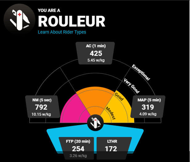

The 4DP is definitely not a “superior” test. The first and only time I took the test, SF claimed my “weakness” was VO2max, even though according to the test my MAP was 122% FTP. Hunter says VO2max only goes up to 120%. Guess the 4DP got that wrong. My AC was also 159% FTP, yet Hunter states the AC ceiling is 150%. My NM was only 295% FTP, if anything that should have been my weakness. SF also labelled me a “climber”, whatever that means. What kind of climbing? And what kind of climber has a VO2max weakness?

Let’s see how my results rank in the Coggan/Hunter w/kg chart (you know the one I’m talkin’ 'bout!):
NM: upper Cat.5
AC: mid Cat.4
MAP: low Cat.1
FTP: upper Cat.2
Very weird that the SF identified my strongest Hunter-based power metric as being my weakness:
I wouldn’t call 4DP a superior test, by any measure. Let’s also not forget that ALL these power curve tests have been around for a long time – anyone can do any of these tests when ever they want. It’s not proprietary. All SF did was jam them all in one test as a marketing tool for the wallet-heavy time-crunched MAMIL demographic.
