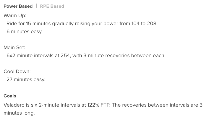

Actually, you can see on the outdoor translation that the 27 mins are coded as cooldown:
“27 minute easy” outdoors would be more legit endurance work, I think, than 27 mins of 50% FTP indoors.

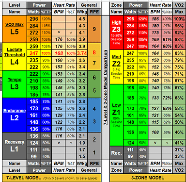

  • Looks like your example above is 50% of FTP.
    • Based on the 7-Level Coggan system (which TR uses), that falls into official Level 1, Recovery.
    • Based on the 3-Zone Seiler system (by my research at least), it’s right on the bubble of Zone 1, Recovery.
  • So I do think it essentially flirts with the Endurance extension goals. It is sure up for debate though, just like so much under the POL umbrella seems to be :wink:
I’m not sure this is “more contentious” because a lot of the research actually substantiates these three zones. (Unless the Polarized 3-zones are different from the ones typically used in research.) I don’t particularly care either way. I find the seven zone system more helpful.
If it’s right at the line between endurance and recovery? I kinda doubt it’s quality work.
