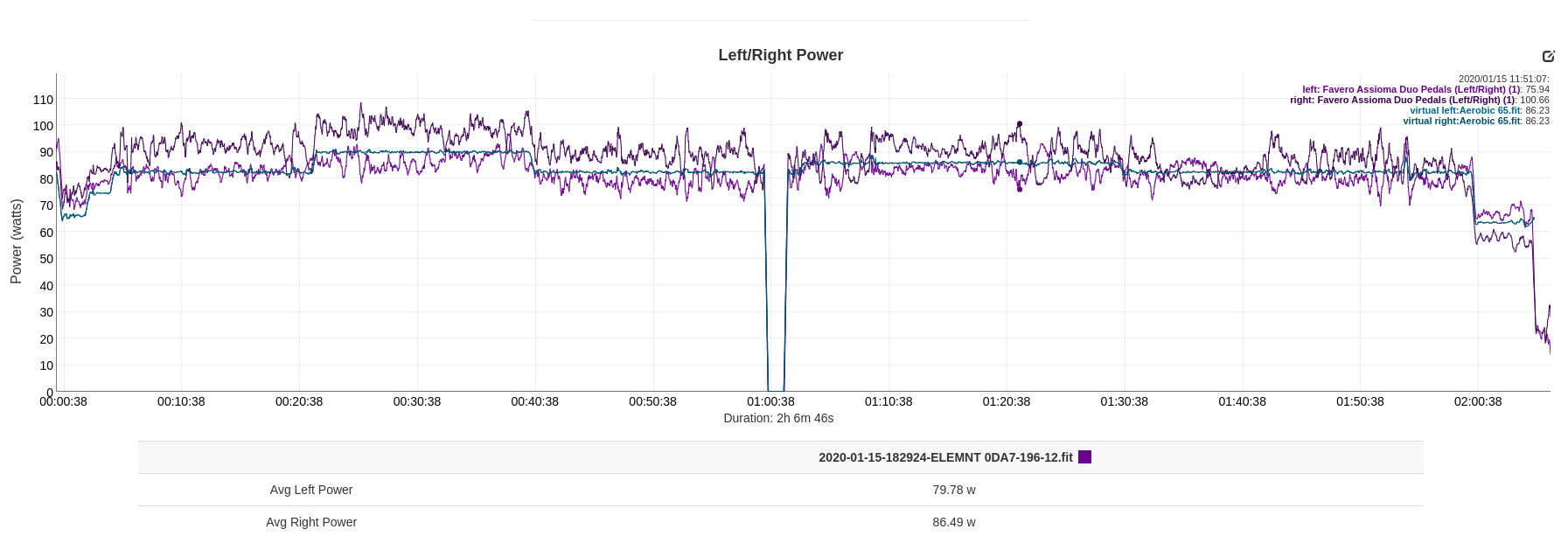

Here is a screenshot from a test of mine a while ago - comparing my assiomas to my H3.
I do seem to have an imbalance - the overall averages are without about 2% of each other. As shown here, you can see some swings in LR balance of fairly large timescales - many 10s of seconds up to a couple of minutes. I have regularly seen these types of variances in the data when I have looked at it. If you look at my cool down, you will see my LR balance swap polarity.

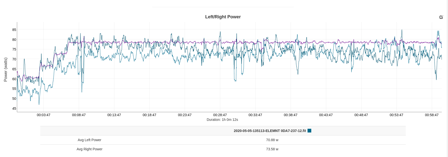

The colors make it hard to see, but here is the LR data from a steady trainer session with the P1s, and the LR balance varies a lot, and occasionally swaps polarity.
The data that you are seeing from your pedals could be a technology thing, and if I am understanding the graphs you have posted you are also seeing and oscillation in total power, not just L/R. For me the total power lined up pretty well, it was mostly the L/R that varied more than I expected.
