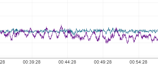

Has anyone ever seen fluctuations in power from their Assiomas that are small but periodic? I get peaks and troughs with a period of a bit over a minute, amplitude around 4 W… very odd! Only small, but weird:
AssiomaPeriodic1
That’s plotted with @dcrainmaker’s Analyzer, link here in case anyone’s interested, using 20 second smoothing and plotted against my Tacx Neo.
Another example here:
AssiomaPeriodic2
Same set-up, link to the Analyzer page here.
Any ideas what’s going on there? The pedals are only a few weeks old, and didn’t do this at first. Not sure if it started after moving from a different bike, or a firmware upgrade, or something else entirely.
Not seen anything like that before either.
First thing I would ask is were you in ERG mode mode? I’m wondering if the power fluctuations are actually real and the Neo isn’t regulating the power level as well as it thinks it is.
Do you have DUO or UNO pedals? It would be interesting to see if both pedals are showing the same undulation.
