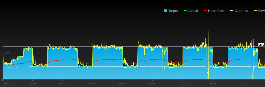

This one has been on my mind for a long time now, and I could trigger a support ticket but I’m wondering if others experience this as well;
Setup: KICKR in ERG + Crank based powermeter in power match mode
Circumstance issue occurs: anytime doing an interval (say 5-10min) and I take a backpedal for 15-30s, don’t pause, and then keep going. The target wattage doesn’t change, but even when i get back to regular cadence the POWER never gets all the way back to target. It usually will sit at 80% of where it needs to be.
It ends up making the rest of the interval easier than it needs to be which is frustrating, but serves me right for taking a break.
Wondering if others experience this?
Good example is shown below where you can see I took a brief backpedal in the later sets with about 2:30 left, and then the power never came back up to target.
