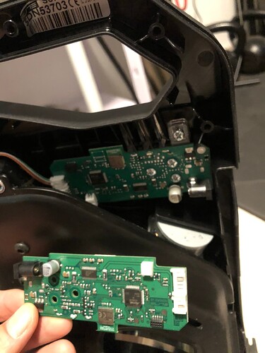

Maybe you’ve tried this, but you can check to see if the magnets are moving. The motor will still move but the magnets won’t. You can nudge the motors and they may move again. I’ve attached a picture. If they don’t move then it could be a board swap. Ive had pretty good luck with their customer service with a similar issue a while back.
They asked me to take a video of the magnets and I sent them but they still didn’t resposne. There is a sound but magnets are not moving… do you maybe know how many time do they need to send thet board (to EU)?
Im not sure if they work weekends but I usually got a response or two per day. The part took about a week to get here to the US. I think it was about 12 days total from my initial ticket submission until I got the part.

I contacted Elites support and they asked me to remove some panel and take a video of magnets positions while turning it on and after they saw the video they sent me the electronic board and instructions how to change it. I took me just a few mintes to do that and now everything works fine.
They have all the instructions and everything ready so it looks like standard suitos problem.
