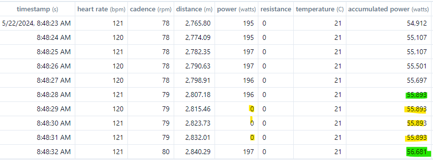

here is a real example, data from the fit file of the next screenshot (jagged power):
56681 - 55893 = 788
788 / 4 = 197, when cumulative is used for the average, it will be the real avg… strava unfortunately doesn’t

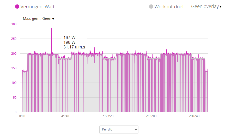

The connect app does show a very jagged graph for power:
So tried to solve this by connecting the trainer (kickr core) via bluetooth, but that simply doesn’t exist… you can only use ANt+ to connect a controllable trainer to your edge, It does seem possible to connect only to the kick power via bluetooth…

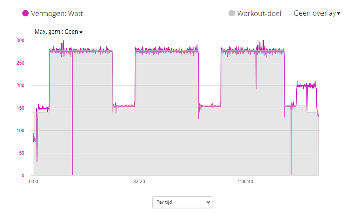

So I decided to remove the battery from my 4iiii left PM, but in the mean time also a firmware update was installed, but the next session was flawless:
Anyway, long story short… data drops can probably happen more easy when there are multiple devices sending out data or trying to connect to something…
