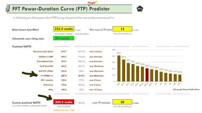

Just use FFT Magic Power-Duration Curve (FTP) Predictor [Link: fft.tips/curve] - Google Sheets, that is exactly what this does. from 254w@15mins <=> 245.5w@20mins (depending on phenotype) <=> 208w-215w@60mins; or sync your data to icu as David suggested :+1: !

If the OP’s FTP/60min power is 208w, then he managed 122% for 15 mins.
