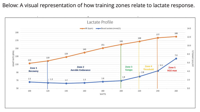

And they had this CONCEPTUAL graphic:
Again its conceptual, where LT1 is the border between endurance and tempo.

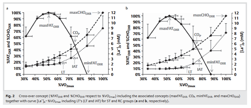

And of course the graph you don’t see very often while reading stuff on the Internet:
That I first saw when getting started in 2016, in the Base Building for Cyclists book by Thomas Chapple (published in 2006).

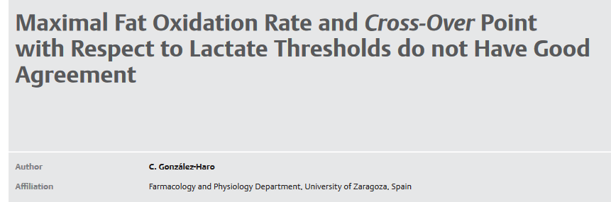

I did. After work will see if I can find the right figure and add it to the above post.
Screen Shot 2022-02-24 at 1.30.21 PM
Everything happening in Zone 2 is the same thing that is happening in Zone 3.
As said here:
https://www.trainerroad.com/forum/t/calculating-lt1-and-lt2-approximately-without-a-blood-test/55533/412

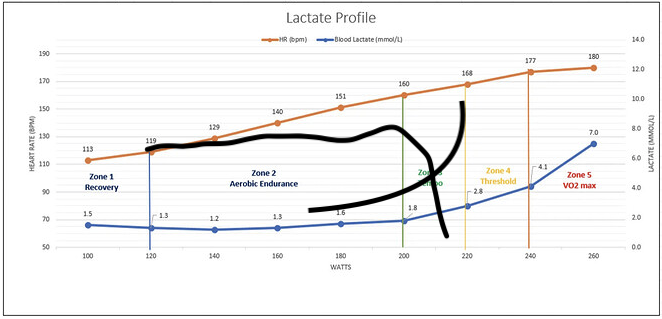

Except for those black lines. Important? Discuss!
from the article:
  • You can see lactate remains very stable through the first six stages (100-200 watts). That is an indication energy is being supplied predominantly by the aerobic break down of fat.
  • We start to see lactate elevate just above baseline between stage 6 and 7 (200 to 220 watts). Although that is not what we label “lactate threshold,” it is a threshold of sorts. We call it the Aerobic Threshold or LT1, and first jump of lactate from baseline is the indicates a greater contribution of energy from the breakdown of carbohydrate.
So yeah, aerobic threshold or LT1 is a marker where aerobic metabolism of carbohydrates starts to increase.

IAT is defintion which yields a lower La concentration compared to other definitions for the upper threshold.
As pointed out before in this forum, LT1 may not be a good predictor for Fat_max but for the outer right edge of a high fat max zone.
we should probably think of lt2 as a range as well.
Yes absolutely, with MLSS at the bottom and CP at the top.
The range >MLSS and <CP is interesting as you get a mix of heavy domain and severe domain behaviours, for example lactate will not reach a steady state, however VO2 kinetics will, and there’s no depletion of intramuscular energy stores (that comprise the W’).
it is a metric to monitor the impact of traininig. Especially for long distance endurance sports it is favourable to have high fat ox at higher intensities, e.g. to move it right. Especially for carb thirsty athletes (see the interview with Bu on Blu’s training, their approach must have been successful in this regard … or this is at least what they claim)

I’m trying to drive everyone to start discussing the crossover concept, because without that, all of this discussion of low-intensity is redundant, or worse, pointless. It’s all the same stuff. Just do a lot of it. But then, as you say, how to measure improvements? How to know where on PD curve and how much to train? With crossover concept, might NOT BE all the same or redundant (endurance vs. tempo vs. low tempo vs. high tempo)
