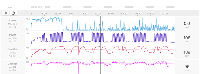

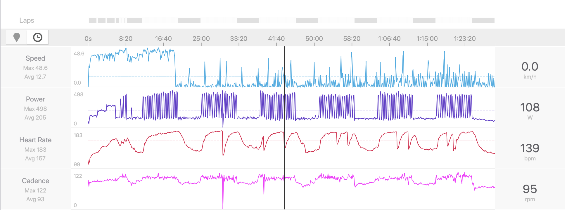

  • Platform: Mac
  • Version: 2019.25.4.44-Beta
  • Devices: Neo, Power2Max
  • Connection: ANT+
  • Mode: ERG w/last 10min using resistance mode.
  1. For the first time ever, production, production beta, or new beta, it took an unusually long time for my workout to show up on TR web. Usually, I close TR. Open browser and it’s there.
  2. It took several attempts including restart before I could edit (i.e., leave a comment) for today’s workout. I could enter the text. Hit save. Then nothing. After a restart. It works. Maybe related to #1 above.
  3. When viewing on the web, the power source is wrong. It says Neo, but power source was definitely the p2max.
The resistance turned up a little doesn’t seem to do anything to the reported speed. Looking at the Strava analytics the speed graph looks really weird-- front loaded really high then pretty much standing still. Also my first broken introduction to Spanish Needle, OMG :flushed:

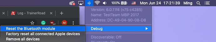

Also, try out this little trick to see if it helps. Press ā€˜option + shift’ while clicking on the Bluetooth logo in your menu bar. An option to debug > reset Bluetooth module should show up. Reset the module and let me know how your next ride goes.

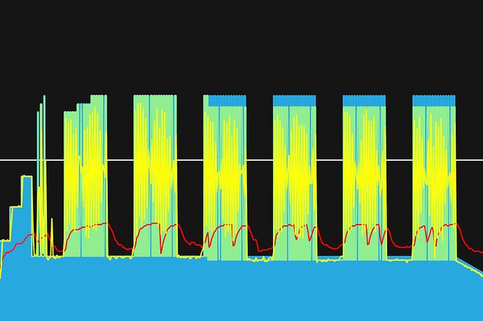

  1. Was trying to pick some workouts out of Off-road Speciality but there was no scroll bar and the mouse wheel nor arrow keys did anything and all I could see was the Short Track plan, couldnt scroll down to see any other plans.
  2. I’ve noticed a few times, where I’ve gone off piste from a workout, like added some sprints, stomps etc to low intensity endurance rides; when the ride finishes it gives you the intensity and TSS vs. the prescribed figures. At least twice this has been way higher than actual recorded. For example, I did Petit+1 this morning, added a handful of high power sprints and when I finished it gave me 66TSS and 0.81IF, looking at the ride now though it says 57TSS and 0.76IF.
