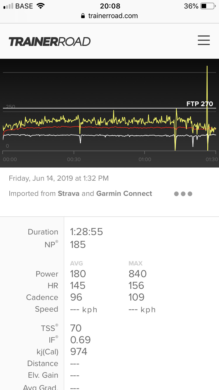

Hi , i did my first outside workout friday , it went great thanks for this feature . However using the 4 recommended fields it did not record my speed and distance i guess i have to add those fields to my garmin ? or do i have to switch to outside workout because it is now on inside ? i have a garmin edge 1030 . PS sorry if this has been asked before
You got it!
Thanks @danielm i changed this and will try tomorrow !!
It should have recorded your speed/distance. Can you link us to your finished TR/GC/Strava file?
On all head units that I know of, you don’t have to display a field to record it. IE if you don’t have a field showing distance it will still record.
Hi @Nate_Pearson
This my ride link ( hope this is What you need )
https://www.trainerroad.com/career/thomas%20de%20kesel/rides/57496960
Please note that my workout was done on the indoor profile of my garmin Edge 1030 ( Maybe gps was disabled and thus No speed and distance was recorded ? )
@Nate_Pearson Hmmm that link didn’t work I think . Here is a picture Maybe you Can find iT in my profile ?
yes, the indoor profile disables GPS. Next time use another profile with GPS enabled.
