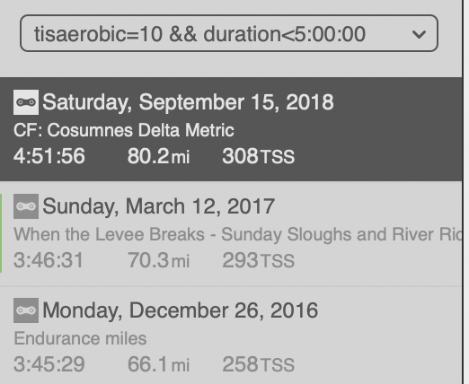

FWIW here are a few of my unicorns (Aerobic = 10 and Duration < 5 hours):
Moving times were less, the Dec 2016 ride was non-stop except for ~15 minutes of stopping at traffic lights. IFs between 0.8 and 0,87. Definitely not z2, and the two most recent scored 10 on both anaerobic and aerobic. The oldest was 7 anaerobic and 10 aerobic. :man_shrugging:
