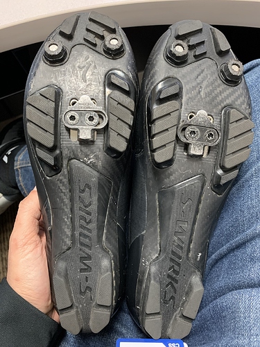

I have a pair of S-Works 6 XC shoes and I prefer using these for road bike commuting and urban riding. I like the walkability of SPDs when getting around the office, or down the corridors of hotels, train station staircases, etc. These Xpedo pedals don’t have the same smooth release and entry I’m used to from my Shimano XT XC pedals, but I’ve grown used to them.
Lastly, I did not have to trim off any of the shoe, but I did have to shift the cleats fully in-board to get clearance. I haven’t done any measurements to see if this is throwing q-factor or alignment off, but I’ve ridden 2 hours in this arrangement and no discomfort.

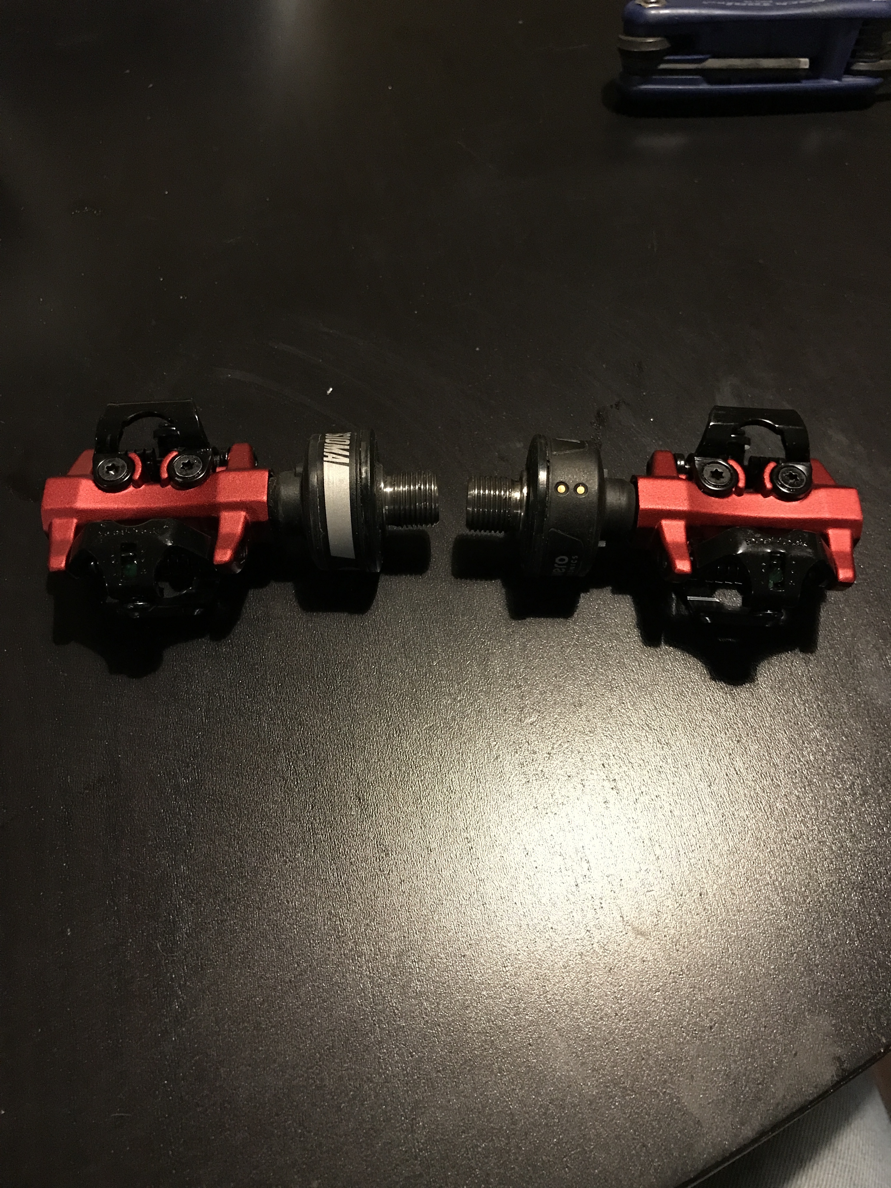

Tried this with M-force 4 cr, doesn’t work as of now based on these instructions above. The problem is the silver inside “end cap” from the Assioma does not slide inside the Xpedo pedal body. So, when you go to torque the nut, the pedal will not spin freely as the end cap is pressing against the sensor. I tried without that inside “end cap” and just the rubber soft washer from the xpedo spindle, but then the pedal sort of wobbles too much without that endcap, doesn’t seem stable like that.
Any ideas? Anyone worked this issue out?
Not getting the same amount of wobble/movement with the road bodies, without that endcap or even with it. I made a quick little video to show the issue, think some guys above were trying to explain this also.
Sorry, heres correct link for the video: Xpedo 4 CR Issue - YouTube
It looks like you got the wrong pedals. You pointed it out that the spindle on yours doesn’t taper like ones Shane uses in his video.
It appears there are a couple variations of the M-Force 4s out there. Not sure which are the latest however since Xpedo doesn’t list them on their website.
I grabbed a couple stills from your video and compared the two spindles and they are indeed slightly different which could account for the added wobble your seeing.
