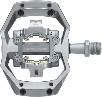

i prefer a flat pedal with SPD and currently use Nukeprrof Horizon’s
